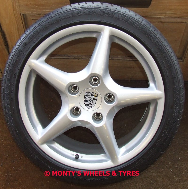

  17. Anyone know if I would need spacers for these wheels to fit my 2000 Boxster? The offsets are 8Jx18" ET57 front and 10Jx18" ET58 rear.

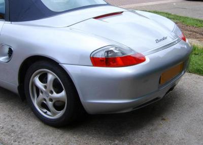

  22. I replaced mine recently and didn't have a problem... I think the crest pulled itself into the gasket as i tightened the nuts, perhaps a smear of liquid soap around the edge might help?
