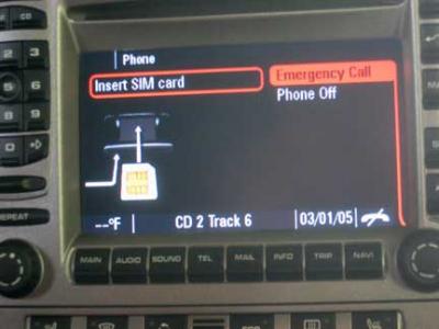

  8. You actually take the SIM card out of your phone and place it in the card drawer and your ready to go. Yes, a bit of a PIA, but your phone book comes along. Once you swap the card from phone to car a couple of times it's not so difficult. Option 2 would be to get another phone and dedicate the SIM card to the car and forward calls from phone to car. In the US you are not able to have a duplicate SIM card All operational info can be displayed in the PCM screen but better than that it is displayed in the OBC under the tach, and operation is controlled by the OBC stalk, where you can call up phone #'s, receient calls etc... a call comes in and you just press the stalk to answer or hang up, etc. If you have a multi-function wheel you can use steering wheel comtrols. Sound quality in both directions is excellent, and operation is easy, no looking far off the road for the numbers or control. :thumbup:
  9. I hate DEALERSPEAK..they are uninformed and make stories up!!! Option 666 Telephone Module, IS available as a Tequipment retrofit. P/N is 997.044.900.71 and as well you will need an optical waveguide P/N 997.622.703.00 Install TSB # is 2/08 9155 (2/21/05, 14 pgs) and is available on your dealers eDCS computer in the document repository in the service area and he can pull it up and print it for you, takes about 2min... Labor listed as 4.6hrs Don't know the parts cost, give the parts dept a call and ask for price and availability of the P/N's listed above. Perhaps you could post the cost when you find out... TIP: If you are a PCA member most dealerships will give a 10% discount on P&L. BTW the GSM phone module works really well, mine was factory fitted and I'am pleased with it's operation and clairity! Your dealership was uninformed...what was suspended was the Porsche "Cell Solution" since they got sued for copyright infringement by the maker. It had nothing to do with "safety issues"

  13. They have done a very good job with the implementation of the GSM phone module, sound quality is great in both directions. She can use her exhisting SIM from her current phone, just take the card out of the phone and pop it in the drawer, bit of a pain since we can't get dupe cards, but after you do it a few times it's an easy task. Coolness is that the stored numbers come across as well, and appear and can be scrolled thru and seen in the OBC window under the tach. Bluetooth at this time will NOT interface with the PCM
  14. The GSM phone is very well engineered and hands free is the way to go. You must have a PCM that has the Sim card drawer ans SOS button to add this option. (early prod cars did not have this faceplate) p/n 997 044 900 71 Telephone Module PCM2 NAV is GREAT as well and well worth having p/n 997.044.900.70 Both options will require an additional Optical Waveguide p/n depends how vehicle is equiped (Bose c/d etc.) You can call your dealers parts dept and ask for stock and availability of the above p/n's Perhaps you can cut a deal for the install of both at once Seperately the install labor is: GSM phone 4.6 hr NAV 3.1 hr
