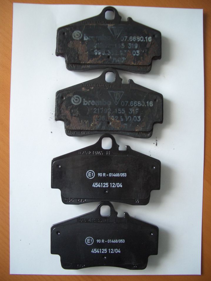

  13. I am sure that I have posted photos on this site showing that Brembo are just rebadged Textars. I can't find them so here you are:

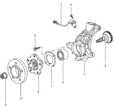

  19. While trying to remove a speed/abs sensor in my '97 Boxster it broke in half as it had become well and truely stuck in the hole. Surprising as the sensor is plastic cased... I have subsequently been trying to dig/drill it out but have gotten nowhere. Anyway, I am now planning on removing the wheel hub and dismantling so I can hopefully knock it through the hole it is in. Can anyone confirm that if I remove the tension bolt (5) I will be able to do this, i.e. that the hole isn't blind? I assume the reason the tension bolt has a toothed circumference is that this alters current produced by the magnet in the sensor and so provides a signal to the ABS unit?
