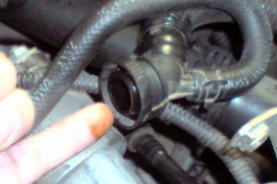

  5. Yes, I do see which Y tube you're talking about, I'll make sure to order one. Does anybody know how to remove the small Y (red arrow on my picture above)?

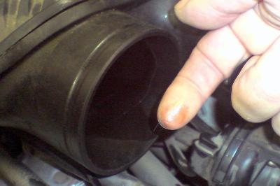

  7. I removed the throttle body and the intake tube connected to it, and there is oil laying on the bottom of the tube: There is also oil in the tube coming from the AOS: So I guess next step is to change the AOS. I wanted to remove the other intake tube, but there a small tube with a Y stuck in it, and I don't know how to remove it: Can I just yank it without breaking anything? Actually, what the easiest way to remove these intake tubes? Do you push the rubber rings on them or out of them on the manifolds? Thanks to all. (Sorry for the crappy cell phone pictures).

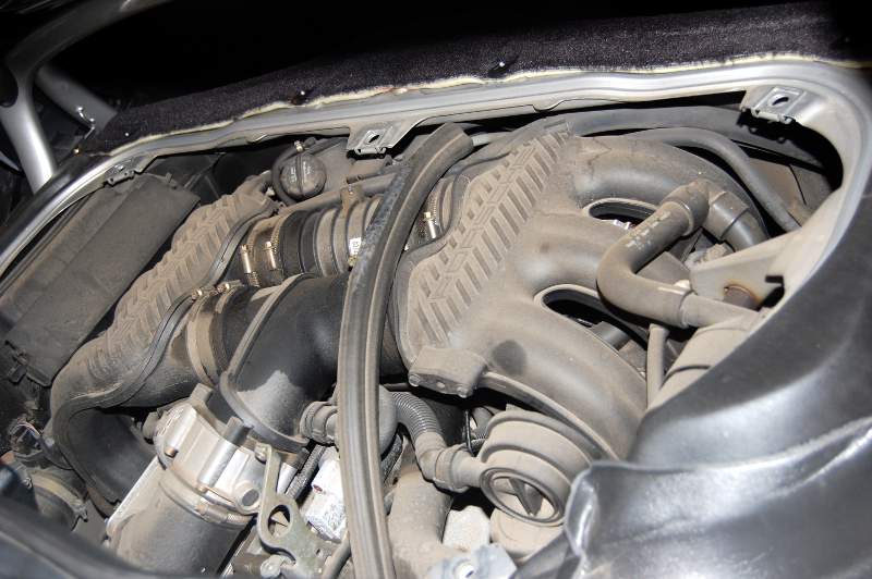

  9. I too have oil on the intake tubes. Few months ago I asked ( here ) if this was an issue or not, but with the replies I got, I didn't bother to open the tubes. Looks like I should ;-)

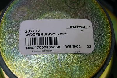

  10. I've made several subwoofer enclosures for home setups and other cars. Sealed enclosures are easy. Vented or passband enclosures are way more difficult to design (even when knowing all the speaker T/S parameters). I found that changing a small thing in the enclosure parameters, like say the vent flare size/shape, and the enclosure behaves differently. Also, sometimes the T/S parameters are way off compared to what the manufacturer's specs say. From my humble experience, I can tell you that changing the Bose woofers for "better" speakers may or may not work, it all depends on how close the parameters of your new speakers will be to the Bose ones. Without knowing the Qts, Qes, Vas and Fs of the Bose speakers to find a close replacement, only luck will give you a better sound. Also, when wiring them, the phase might be reversed as the Bose box is designed to use the rear wave of the speakers. I still have a stock setup in my Boxster, but I will later this year try to improve it. I will probably ditch the stock amp for something better, change the dash speakers, and rewire the Bose box with the two original woofers in series so that I can drive them from my new amp (with active LP filter), and see then how they sound. Until someone finds or actually measures the T/S parameters of these woofers, it's probably better to keep them in the box. I'd be interested to see pictures of your setup. I don't want to give up too much space in the front trunk.

  13. My Bose subwoofer has one pair of these :
  14. Many thanks for yours answers. I understand what the AOS is for and how it's supposed to work, and that a bit of smoke upon startup is not unusual. I'm a bit skeptical however with the fact that oil on the intake pipes is normal. When I bought the car two years ago (60.000 miles) , the engine was dusty but there wasn't any oil deposit on it. I do understand that a tiny bit of oil might get back into the air intake stream, but getting such a layer of oil on the intake tubes suggests (to me) that there is actually too much oil getting back into the throttle body, thus my suspicion that the AOS might not be doing a good job anymore. That or the air intake tubes aren't clamped tight enough somehow. I've never seen photos of Boxster engines like this, either here or elsewhere on the Net. Do other fellow Boxster owners have oily intake tubes like I do? To put my worries to rest, should I remove the throttle body to check if there is too much oil in it? (BTW, I'm not a native English speaker, hopefully this isn't too obvious.)
  15. Hello to all, Long time reader, but first post. This forum is just amazing and I've learned a lot. I have what seems oil on my engine's intake tubes. I don't know for how long it's been there, since last time I opened the engine bay was something like two years ago, but the car's been serviced a year ago at my local dealership and they didn't mention anything, so I assume the engine was clean then. This seems different from the usual symptoms of a failing AOS, from what I've read here on the forum. The car runs fine, only sometimes I get a bit of smoke on cold morning for few seconds. No code on my Durametric. This is a Boxster S, MY02, 80.000 miles.
