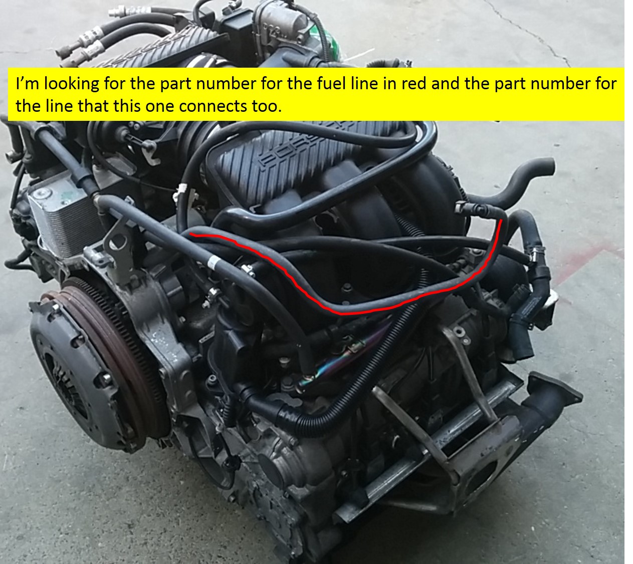

  16. Thanks. I prefer to replace the two lines to fix the problem. I was looking at the Katalog, but I couldn't figure out the exact part numbers they are. The graphic shows the engine side line that needs replacing; also I need the part number this line connects to on the body side.
  17. I have a 2002 3.6l. The fuel line quick disconnect that comes from the splitter on the back of the engine to bank 1 (Between coolant reservoir and engine) side fuel rail started to crack. I am looking for help with either the part number for the male and female fuel quick disconnect or a source where I can buy the set that will fit the 996. Ideally the part number(s) for the entire fuel line from the fuel filter to the engine and the fuel line from the splitter to connect to the fuel line from the filter. I found a source on ebay from China for just the male and female quick disconnect, but I'm weary to make that purchase. Can someone help me out here? Thanks.

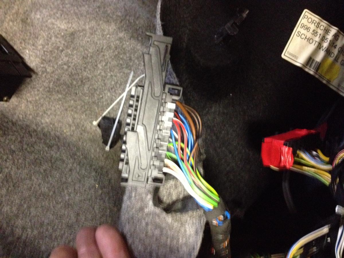

  22. Can someone help identify what this plug is for? I believe it's for the Bose radio upgrade amp/cd Changer from the Factory. It's part of the front wiring harness. It's in the luggage compartment (Passenger Side) of a 2002 996 C2 Cab. Thanks
