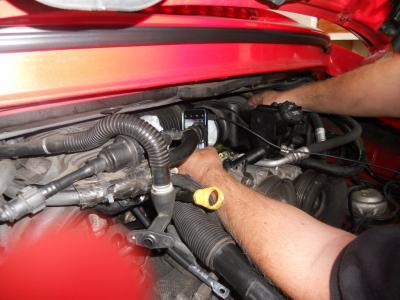

  11. Returning from a long business trip I started to put everything back together today. Right now I'm going through fiddling with the alternator reinstall. I remember how tricky that was last time. Updates: The first image shows how to locate the rear bolt on the AC Compressor. I've removed my wedding ring and slid the solid freon line between my 3rd and 4th fingers (counting thumb as #1) highlighted by the yellow hand drawn lines. By doing so you should be able to touch the head of the bolt. The second image is another shot from beteen the intake runners. The 3rd shot shows how I'm holding my phone in movie mode with my left hand (power lead because my battery is nearly dead) and have my fingers between the solid AC line, while my right hand is holding the top of the bolt. I can see from the phone/camera exactly where the bolt is and my left hand fingers can nudge it into place. The next 2 pictures just show the camera/phone location clearer. The last picture shows the rear bolt angle the same as the front 2 as the extension bar lies between the intake runners. For a video see the follow up post. I ended up repeating the whole procedure due to dropping the temperature sensor rubber grommet behind the AC Compressor during re-install. I can confirm the AC Compressor can be removed in 5 minutes and installed in about 7. Mark

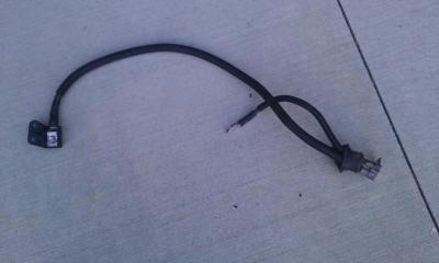

  12. Solved. Here is the offending cable out of the car, waiting for the new part arrival. For me the bolt on the rear of the compressor has to come out (who knows how I'm going to get it back in), see picture - there's a bracket that connects the bolt (red circle) to one of the refrigerant lines that is just not reachable. On the refrigerant side It has a 10mm bolt on one side and a 5.5 female hex on the other (yellow circle), but neither location is accessible unless you have 5 year old's hands. Mark

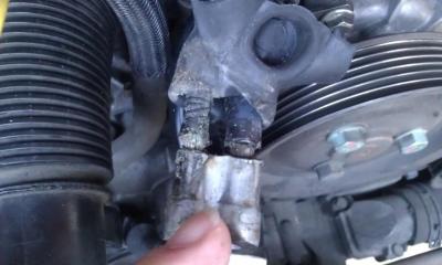

  14. The connection at the starter was the problem, heavily corroded - see first 2 images below. My car spent 3 years in Boston, and the last 10 in Southern California where it hasn't see rain since. Parts ordered, but not in stock, so I have 5 days to figure out the last 2 challenges... I've succumbed to the fact the AC Compressor has to come off. I removed the temp sensor and can see a bolt which looks like it's on a bracket directly below what appears to be a HVAC line - see next image. Is this the correct bolt? Just a little concerned on how to get it back in after removal. Anything else I need to know here (other wires/hoses etc to come off)? Any gotcha on that rear bolt? As far as the power steering reservoir. I presume rotate the red circled (last image) lock at which point whatever is in the reservoir is coming out (unless I suck out what's in there first). Is that correct? Thanks Mark
