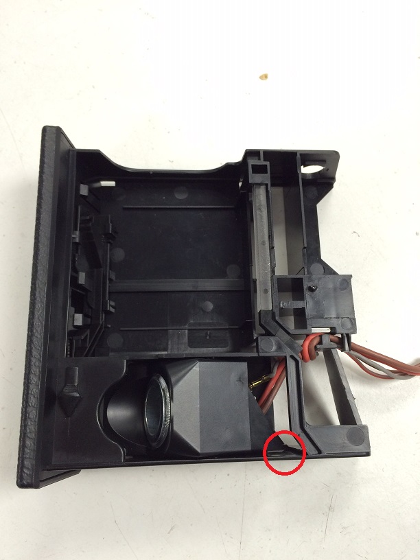

I took the assembly apart and found there is a pivot knob on the right side of the tray was broken off. Luckily I found the piece and used some strong glue to hold them back together. I searched and found this a common problem and Porsche doesn't sell the part, only the whole assembly for few hundred dollars .
