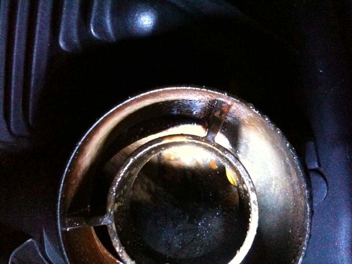

  5. Thanks again Maurice Yeah I need to revise all that previous speculation. When I got home I checked the pressure release valve and it was not popped up. I'm assuming that means there was not excessive pressure. I also didn't see any residue indicating an excessive overflow that would account for the dump of coolant. I was also wrong about the coolant level. I checked again and it was close to min. So looks like a pressure test is in my near future. Probably will end up being the coolant tank. Will update. Any coolant suggestions? I've read some back and forth about using only Porsche or VW coolant over regular Prestone. What I did find, in the picture below, is what was probably causing the P0491 and P0492 CEL. I'm no gear head but I'm pretty sure that hose should be connected to the secondary air blower. Hose clamp must had fallen off. Is there a way to clear the CEL without disconnecting the battery? Otherwise I'll be posting on the Radio Code Help sticky pretty soon...lol.

  8. kcs: Since your coolant cap ends in "01", definitely start by replacing the coolant cap. Since you have gotten a CEL, go to any auto chain store and have the code(s) read and post them here. If the CEL starts flashing, don't drive it as at a minimum, you may damage your catalytic converters. The "steam" that you see may just be coolant leaking onto the exhaust, but you have to pinpoint the cause of the leak. Eliminate the coolant cap from the equation and go from there. Regards, Maurice. Thanks for the advise Maurice. The CEL was not flashing so I went to down to Autozone to get the CEL checked out. It came back with code P0491 and P0492. Something about insufficient air flow, possible air solenoid valve or faulty relay. I'll have to research that on the forum. Do you think that has anything to do with the coolant leakage? I got the new .04 coolant cap and put it on today. I drove it around for about 10 miles at low RPMs and the temp stayed around the 182 range the whole time. When I parked the car there was still a slight coolant leakage from below. I attached a pic. No steam this time so it seems to have improved a little bit. Not sure if the new cap had anything to do with it or not. In the picture you can see the coolant. Not sure if it's coming from there or dripping on to there. I also checked the coolant and there doesn't appear to be any oil in there. I opened the cap to the oil and it looked a little suspect. It almost looked like curdled milky residue if you can see in there. When I checked the dip stick the oil looked ok.
