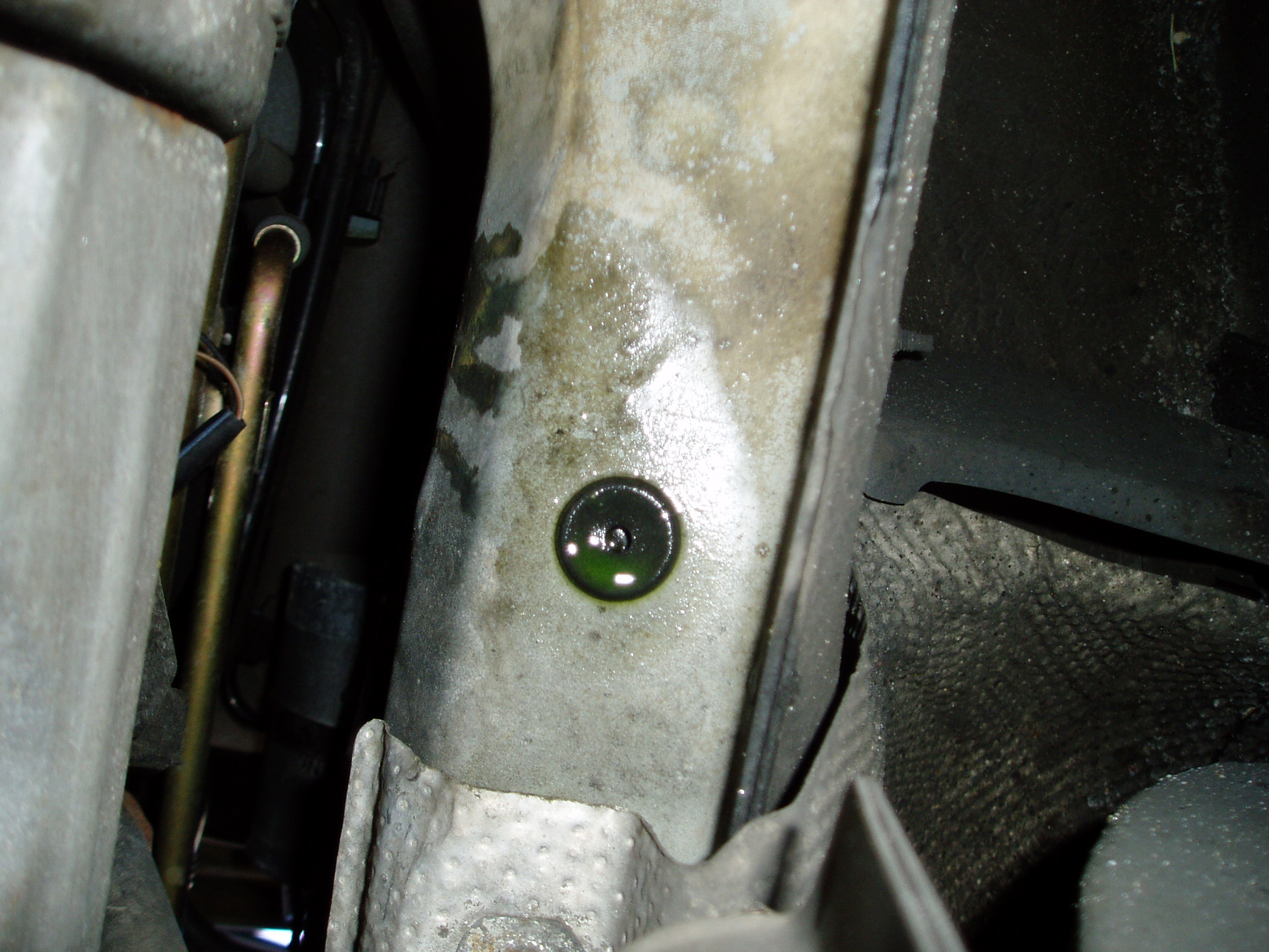

  12. I have discovered a coolant leak today while doing my oil change. I have been smelling coolant over the past 2 weeks after driving as well. The level is fine, and the tank was replaced this past summer so it should be good. However I have attached a pic to show where the leak is flowing down. I can't seem to pin point the problem. but it seems to be coming from the bottom of the tank. I can't however see it directly as there is too much stuff in the way. What is at the bottom of these tanks. Also I found a lose hose with no connection hanging down...is this a overflow hose? Any troubleshooting tips would be great help. TIA

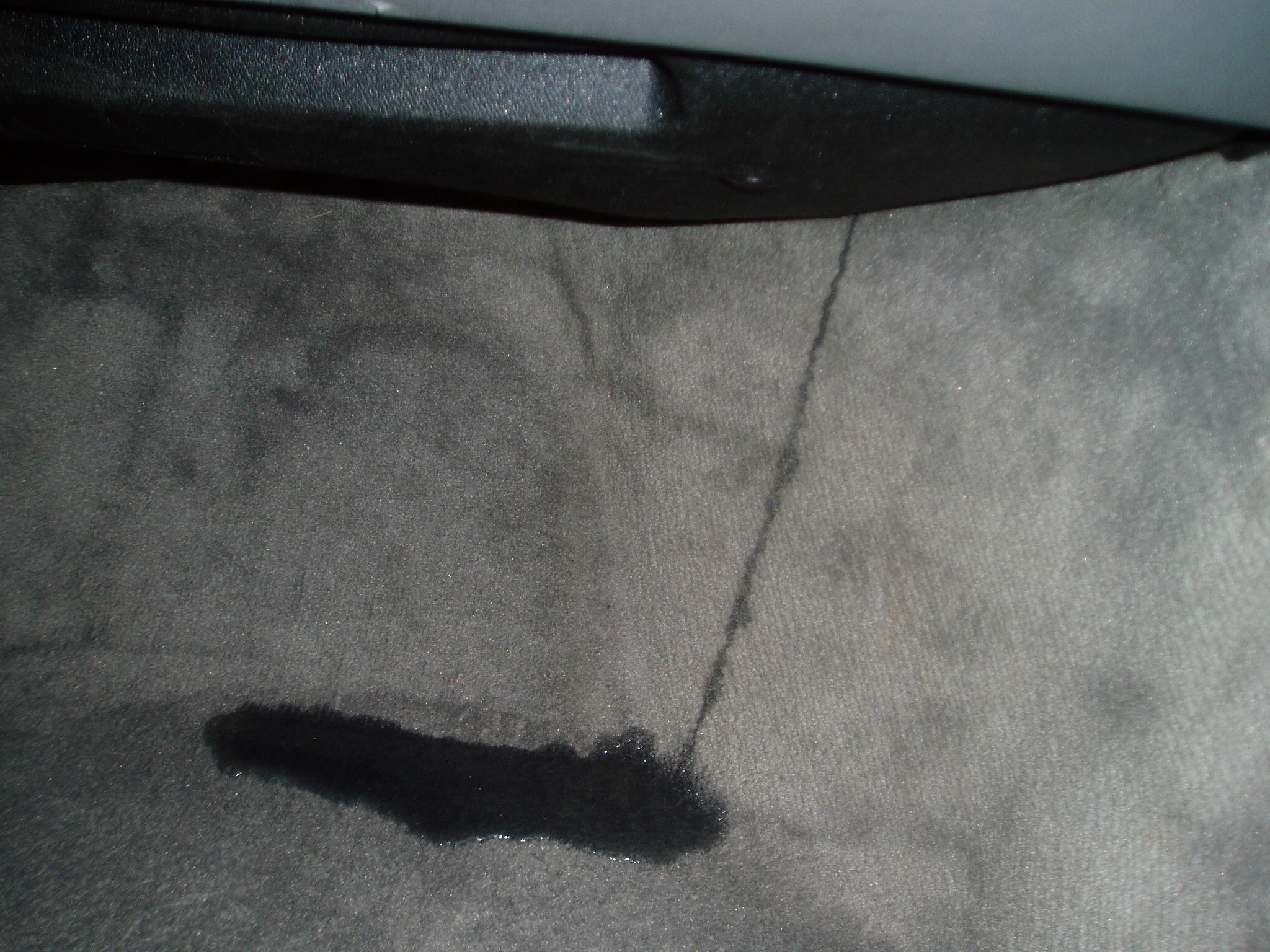

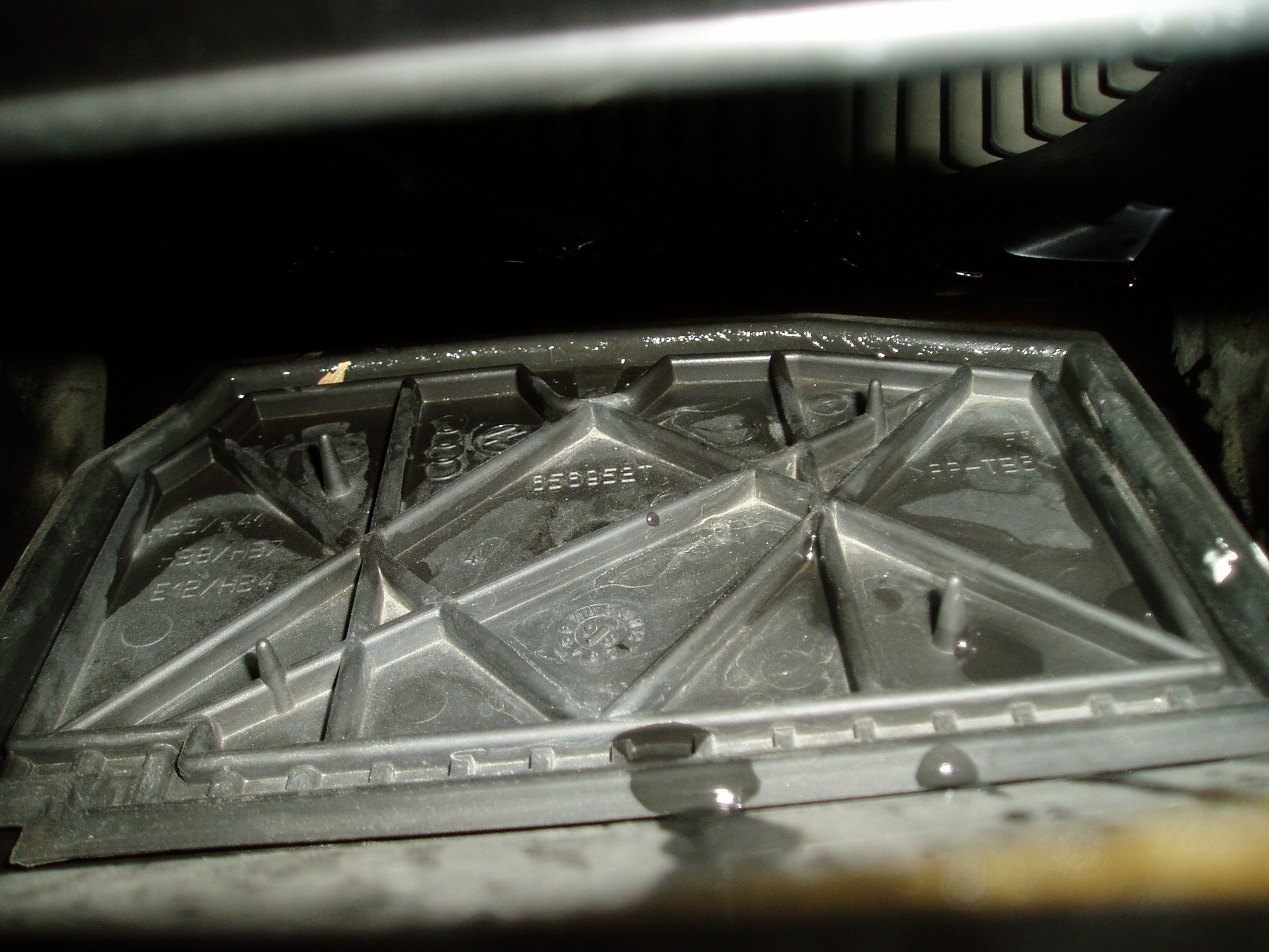

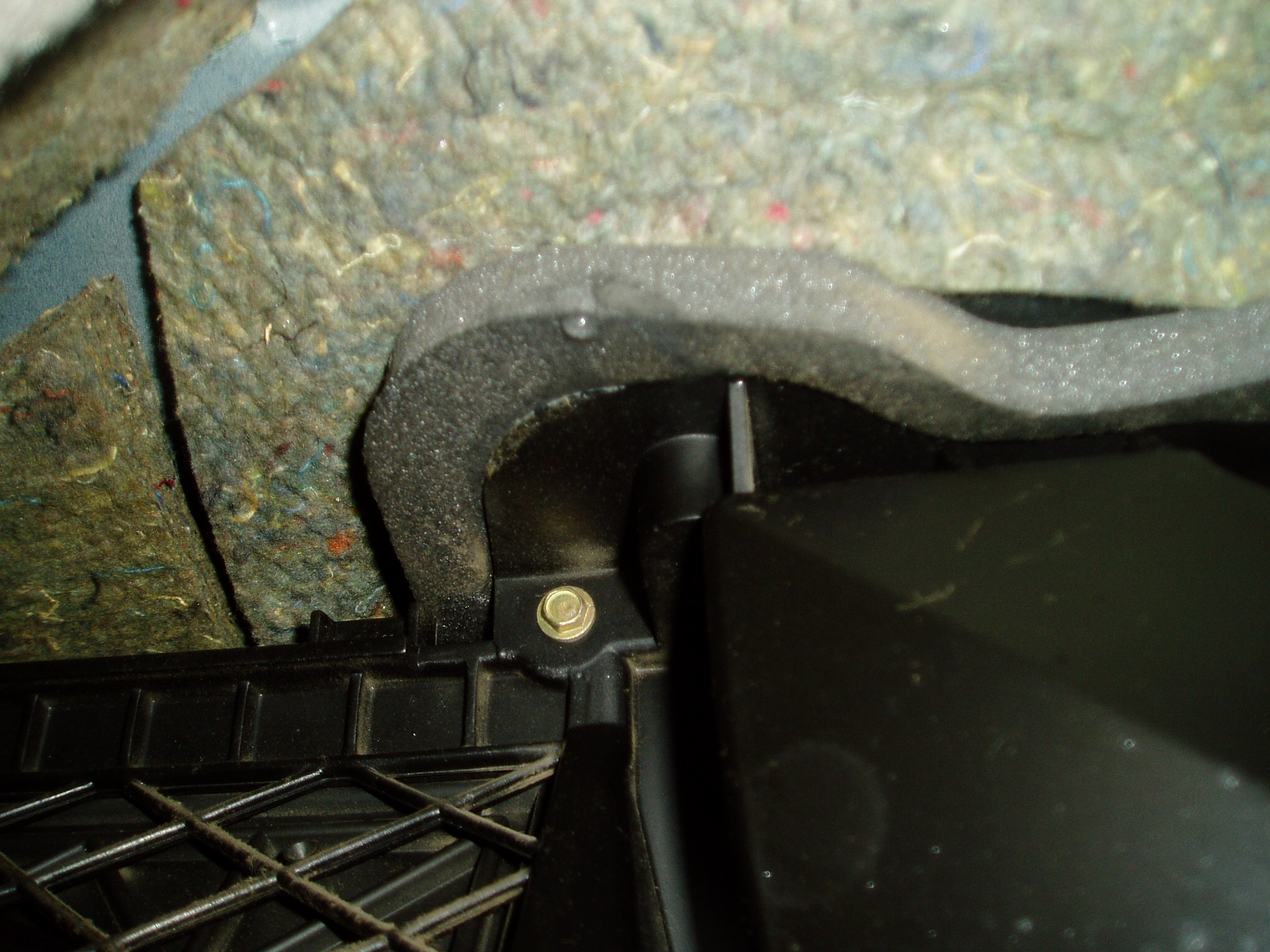

  17. more leaking pics. I think it might be water dripping into the air/pollen filter vent, building up and leaking from there. Not sure how I fix that though. Need help! lol

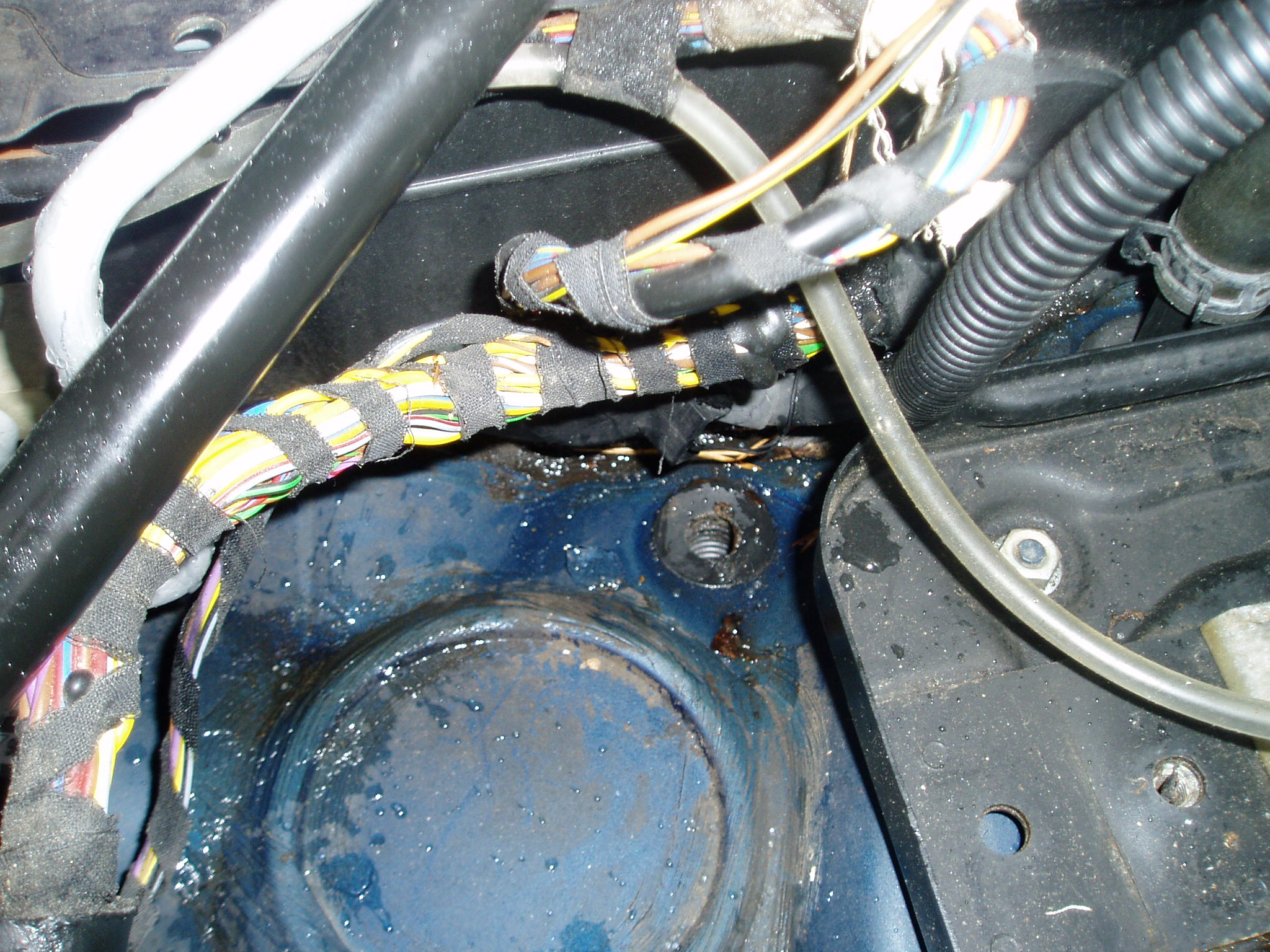

  18. Okay, i've heard of people having this issue and searched the forums and thought I fixed the problem when it came back. I cleaned/blew out both drainage lines in the front truck area. By the battery. Drove it through a rain storm and no new issues. Today I parked the car on a hill facing down hill and found the leak had resurfaced. I attached some pics. I can't seem to find the moon roof drainage lines. I've seen the diagram loren posted. Any advice or tips?
