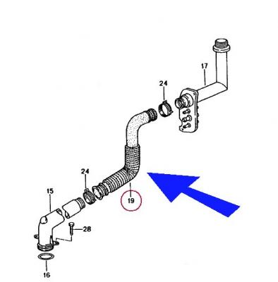

  7. Practice :) If you want it done right, remove the AOS and replace that oil pipe. The engine pulls a vacuum on itself. If that pipe leaks, it is essentially a vac leak and becomes unmetered air entering the intake. It is not a lot.. but it will also stress your new AOS if it is leaking. You are good at it now. Just get some of those brackets out of the way!! make it as easy on yourself as possible!! Something else I do: CLEAN that area before you start on it. I believe you have "Simple Green" over there :) B

  11. You really should have replaced that oil fill pipe. They are not expensive and the new ones are of better quality :( Much easier when the AOS is not in the way. B

  22. Ross? how many miles are on the car? If the oil filler pipe has not been replaced, I'd do it now also! It is MUCH easier to do when the AOS is out of the car!! Let me know what year car you have and I'll get the oil pipe part number for you :) B
  23. It is fine where it is :) it is just MUCH easier to move all that out of the way :) B
  24. 996 107 023 04 They are running about $100 for them right now :) I did a write up on another site back in Dec. :) AOS INSTALL ON A 986S B
