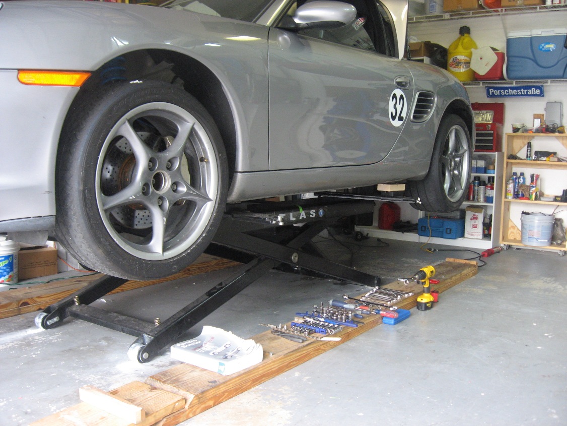

  11. I'd like to offer an alternative to jack stands. This is a hydraulic scissors lift. Advantages: * very easy and fast to get the car off the ground * can lift 6K lbs (I service my truck on it) * includes an automatic locking mechanism * can be taken with you if you move * you do not need tall ceilings, and it will lift 40+ inches if you have the room * it is really stable Disadvantages * while they claim it is portable, it weighs 1000 lbs and is really hard to move around * it will dig into the concrete but this is easily mitigated with a steel plate * because of this particular model's design, you do not have full access underneath like you would with a 2-post lift * your car may be too low to ride over it (note I have runners to get the height to go over the lift) For me, it is great - inspect/adjust tires, brakes, suspension torques, change oil, filter, transmission oil, sway bars, wheels, struts, wheel bearings, etc.
