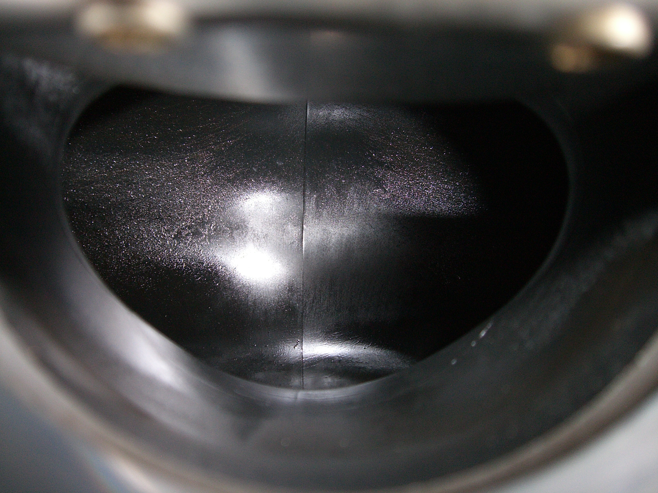

  8. Hey Loren, Thanks for the clarification, the site has helped me get over the fear of working on my own car quite a bit. The there's no oil on the outside, and none that I can see around the valve opening area. The picture I took was opening the valve trying to look inside, except I can't tell if it is oil or just carbon build up. I was hoping that you can tell from the picture. Am I supposed to completely remove the throttle body from the car to look at it from the part where it attached to the engine? If the AOS is bad, is it supposed to be an obvious amount of oil? Does the oil get on the valve and where it connects with the rubber housing? I didn't see any there, and didn't feel any oil as far as my finger can reach into the throttle body valve opening.
  9. Thanks for the advice Loren. I took out the MAF again, and sprayed it with some MAF cleaner on the metal sheet in between the plastic. I also took the rubber hosing to the throttle body off and check for oil. There's no oil in the rubber hosing, and I cleaned the throttle body valve of gunk with throttle body cleaner spray. I didn't notice oil near the valve. I did take a picture deeper in to the throttle body, I can't really tell if the attached picture is what you would consider a film of oil, or if it's oil at all?
