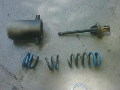

  4. i installed the new power spring and cannot believe the difference. Pedal effort is minimal! Just think, i was about to replace the clutch and already pursched the parts.
  5. just an fyi. Several months ago i heard some noise while depressing the clutch and then it seemed a little more difficult to depress. last night it made the same noise but this time the clutch pedal became noticably firmer. took out the clutch power spring and found that it was in three pieces. will update this post after installing new part this week.
