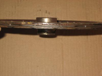

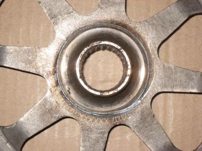

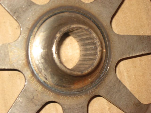

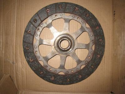

  8. I recently had a 3-time malfunctioning clutch that was misdiagnosed. I switched mechanics after the rattling clutch gave out on me after about 1 year of driving with the noise. The tapping or rattling noise was present when the car was idling and it would wax and wane (not there when car was cold for the first start of the day). I was fed up with the Porsche dealer who I originally went to for the clutch repair but the noises kept coming back. They were clearly over their heads and skill level. They supposedly replaced the clutch kit and flywheel twice. A new clutch has now gone in again with my new mechanic, and the car is running fine now without unusual noises. Check out these photos. Has anyone seen anything like this? The central splines of the clutch disc that fit along the main shaft have completely sheared off. Car has never been tracked or abused. Any thoughts? By the way, this is off a 2002 C2 at 43K miles.
