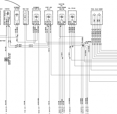

  9. I got only the 2002 wiring diagram hope this help
  10. there is a start lock relay between starter and DME but your problem seems to be a weak battery...

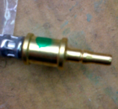

  22. I don't understand... You don't have the hose already out of the car on your workbench?
  23. There has to be a way to disconnect the fitting from the hose (stupid to say from me). Circlip of some kind because the base of the new fitting looks exactly like the base of the old one. Keeps us inform of your findings. That is not something we have to dismantle when we replaced the slave....
  24. Looking at the picture of the new unit...Looks like a theaded portion is going into the assy....
  25. I am trying to understand where this hose goes to. One end seems to be good for the fitting onto the green line but the other end ??? It doesn't fit into the new unit that replaced the slave ?
