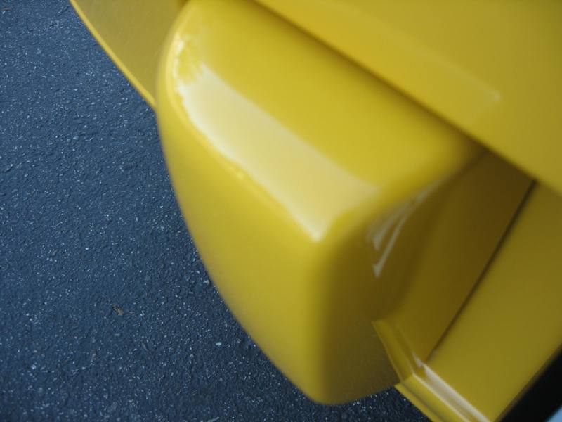

  11. Just installed my Speed Yellow Bumperettes - painted by Eric. All I can say is AMAZING! They are flawless!. If you have been putting this off, call him and do it. Totally revitalized the car.... http://www.bumperplugs.com/BPindex.html
