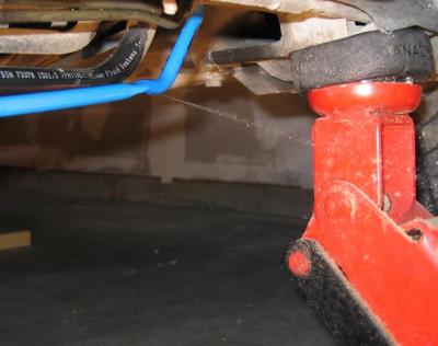

  10. Update: I finally received the parts I ordered for the clutch line repair last night. I had the new line installed and power bled (via motive) in short order. Also installed the new belly pan (which came with a small crack in it :( ). I took her our last night and again today to test it out, all is good :). It is cold here in MN, but it is sunny and the roads are dry today...a great day to drive a 911! I missed not being able to drive the car the last couple weeks. Thanks again everyone for the advice. Chris. P.S. Now that I have the power bleeder I am tempted to replace all the brake fluid but maybe I will wait until spring.

  15. That is right the line is NOT plastic. It just looks like it might be. It is metal with a blue vinal coating; it has what look like brass fittings on either end. Seems pretty heave duty to me. I removed the leaking section of clutch line at lunch. Unfortunately no parts places that I have contacted stock the replacement so I will have to wait a week before I can drive my 996 again :(
  16. Well here are a couple of photos I snapped this evening. The first shows the leak/squirt when the line has some pressure. Also note the line is crushed, either caused by the car bottoming out or possibly a misplaced jack. This photos shows the crack in the belly pan. The missing part in the middle fell out when I was removing the belly pan. Chris

  19. Yes, as many of you suspected there is a clutch fluid line leak. I did not take a picture yet but the leak is just in front of the drivers side rear jack point. It is right where the line makes a turn to go to the tranny. The hole is not visable by my naked eye but when under pressure a nice spray is visable. After raising the car it was pretty obvious where the leak was, there was a crack in the under belly plastic panel right under the clutch line and the clutch line was somewhat crushed above this. I noticed the crack previously but did not think much of it. My next question (and I will ask the parts guy as well), is what do I do? Is there a line repair kit or do I just replace the line? Thanks again, Chris
