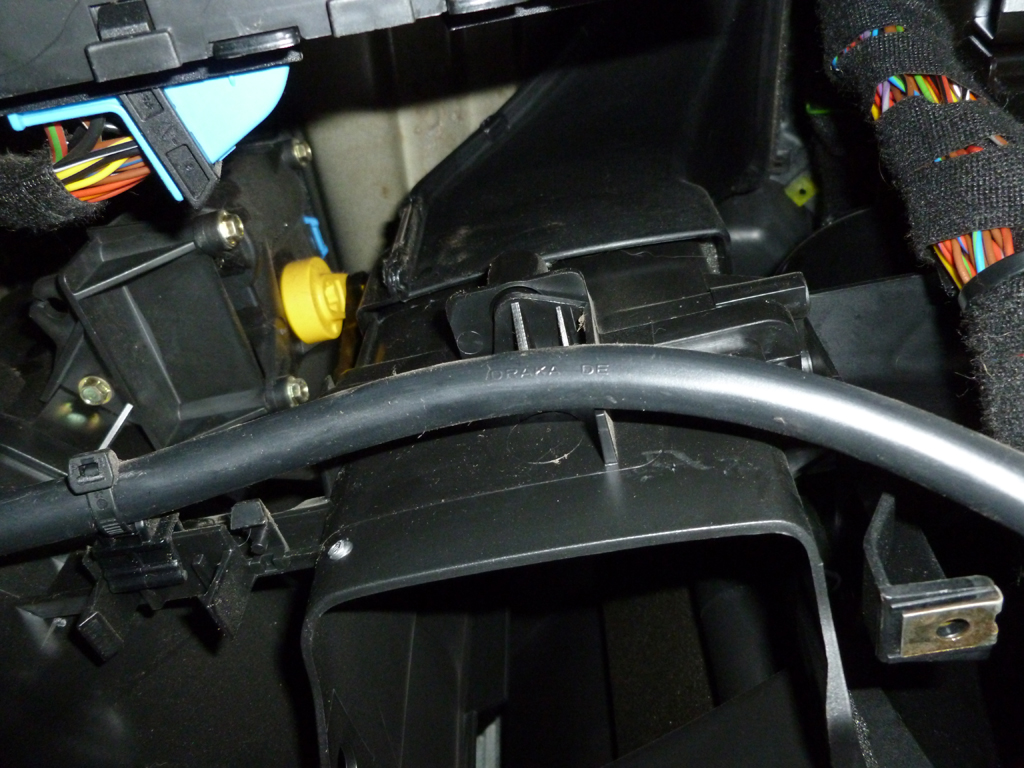

  1. I circled the mold outline of where the sensor should be according to the diagram. The yellow is the lever arm for a flap adjusting servo. I can get a better picture tomorrow. The photo is looking up from the drivers foot well with the foot-well air vent removed. This is an early '05. Maybe there were some more running changes? I also pulled the stereo out to get a better view of the center and no luck spotting a sensor. I have the sensor that I am looking for in a baggie so I have a visual reference of what to look for. I appreciate the help, May have to step back and do a sanity check again. Thanks again! -Greg
  2. Thanks, that is exactly the diagram I was looking for. However the sensor isn't there... Here is the photo:
  3. So I have scoured factory manuals and the internet to no avail. My A/C is not working due to the compressor being in 'CAN shutdown' state. This is because the 'Air intake temperature sensor' reads -42 degrees. I found the one linked to the AC condenser on Pelican and bought one just to have it. After much digging I found that there are two sensors and the computer takes the lowest reading. If that reading is below 38 degrees it will not allow the compressor to engage. Now here comes the problem. I cannot for the life of me find that sensor. The one up front behind the grill is easy, that one is working fine. But I have only found reference to the one in the ventilation system for condenser intake temp. I removed the glove box, cabin air filter and blower fan. I only see what might be a humidity sensor in the air path. Do I need to pull the whole dash off? I have poked around with a mirror but cannot find the location of the sensor. For reference the sensor that I am looking for is part# 1H0-907-543-A-M5262 Anyone have any hints or suggestions? I really want A/C back! I have only found one mention of this kind of issue and the result was 'a bad wire'. But that was after extensive work was done to the car. I want to find out if it is the sensor itself or a bad connection. Thanks in advance! And here is a fun image of some of the other projects that I have been working on.
