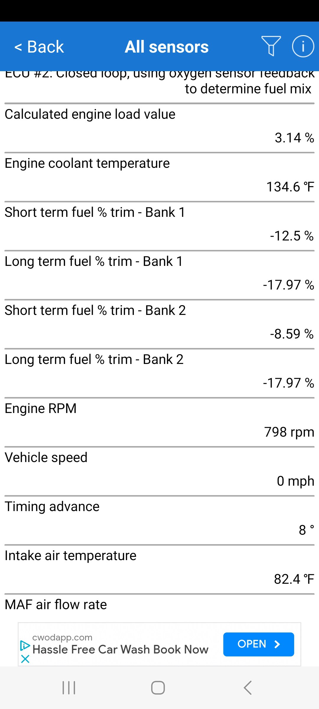

  1. Ok smoke tested through the tee on the aos top, no smoke noted leaking. Aos bottom hose was alittle rattling near the connection pushed in. Smoke was in the intake to the filter but none under oil fill cap I guess that's separate . Data recorded fuel trim short term positive 14-16. Long term -3.1 , symtoms slight stumble on cold start no codes A bit of oil on the right rear wheel well frame.

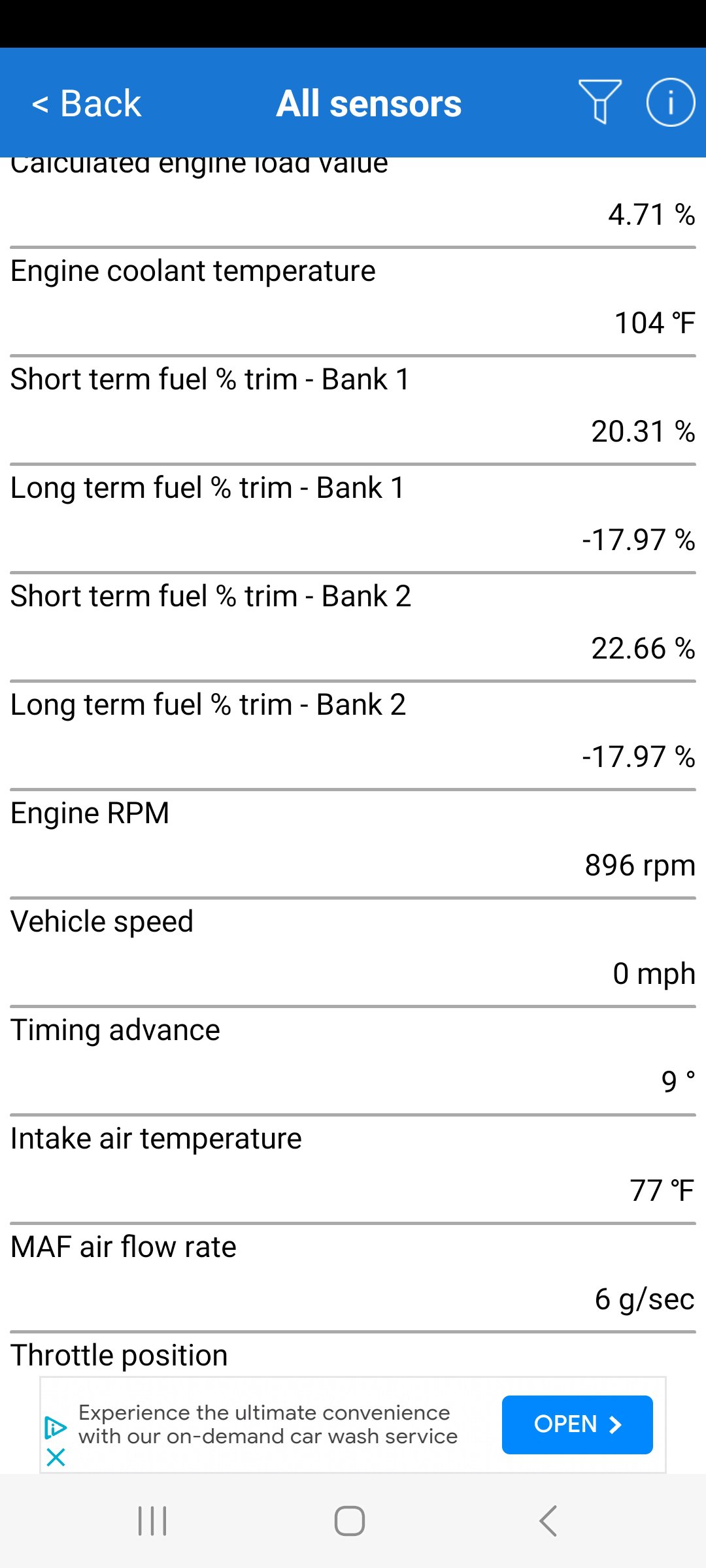

  3. i got a bremi maf this time seems to work fine porsche seems to be double displacement for maf idle 3.2 x2 = 6. fuel trims around 3 -4 now. there is a little hickup when the idle kicks down during warm-up.
  4. Today I got bad idle on a cold start up practically stalling and like a mini backfire. So I checked all the clamps . Has alot of power but bucks and notchy in gear at times. Has original fuel filter. So not fixed by replacing maf no codes yet.

  6. A Follow up, new maf finally got the right part #, no more codes but still runs alittle ruff mostly start up idle long terms are still neg but less. Don't know what else to check. Everything is new. Aos,plugs,coils.a dealer replaced the bad alternator with a bad rebuilt one? Still noisy sometimes.
