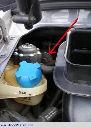

  13. I will be changing my cracked tank in the next few days. I have read all the DIY's and threads. I have a quick question. There is a cylinder shaped thing on the right side of the tank quite deep inside the engine bay. (i will try to post a picture) What is this and does it need to be removed ? If so how do i remove it ? Can the tank come out with it in place ? None of the DIY's mention this or show it on the photo's, but it looks to be in the way. (i have a 2001 C4 Cab if that helps) Any special tools needed for this job (metric sockets, wrenches and allen keys ??). Do i need a special tool for compressing the hose clamps ? ANy other advice ? From the DIY i guess i do the following: Remove the Air Filter (single bolt ??) Remove the Air Pump (2 bolts and one nut) Remove 2 fuel lines (do i need to do anything special here ? Blead something afterwards ?) Drain the coolant from the one drain plug at the engine bottom Remove 3 hoses and 1 sensor from the coolant tank Carefully pull the tank out Thanks
