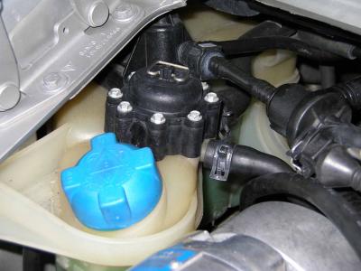

  13. In the 99, there is an electric sensor that installs into a cavity on the bottom of the tank. It reads the coolant level.
