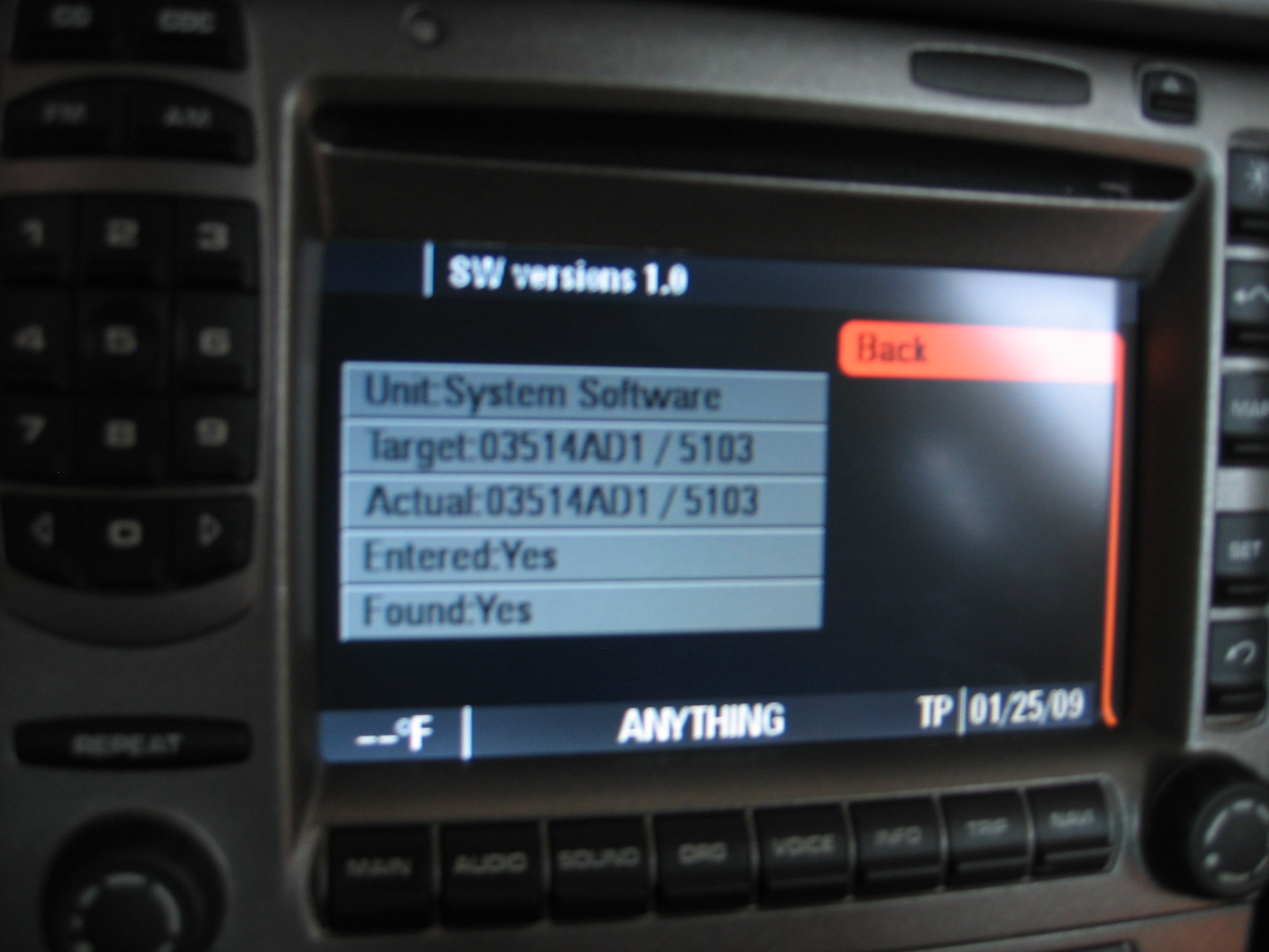

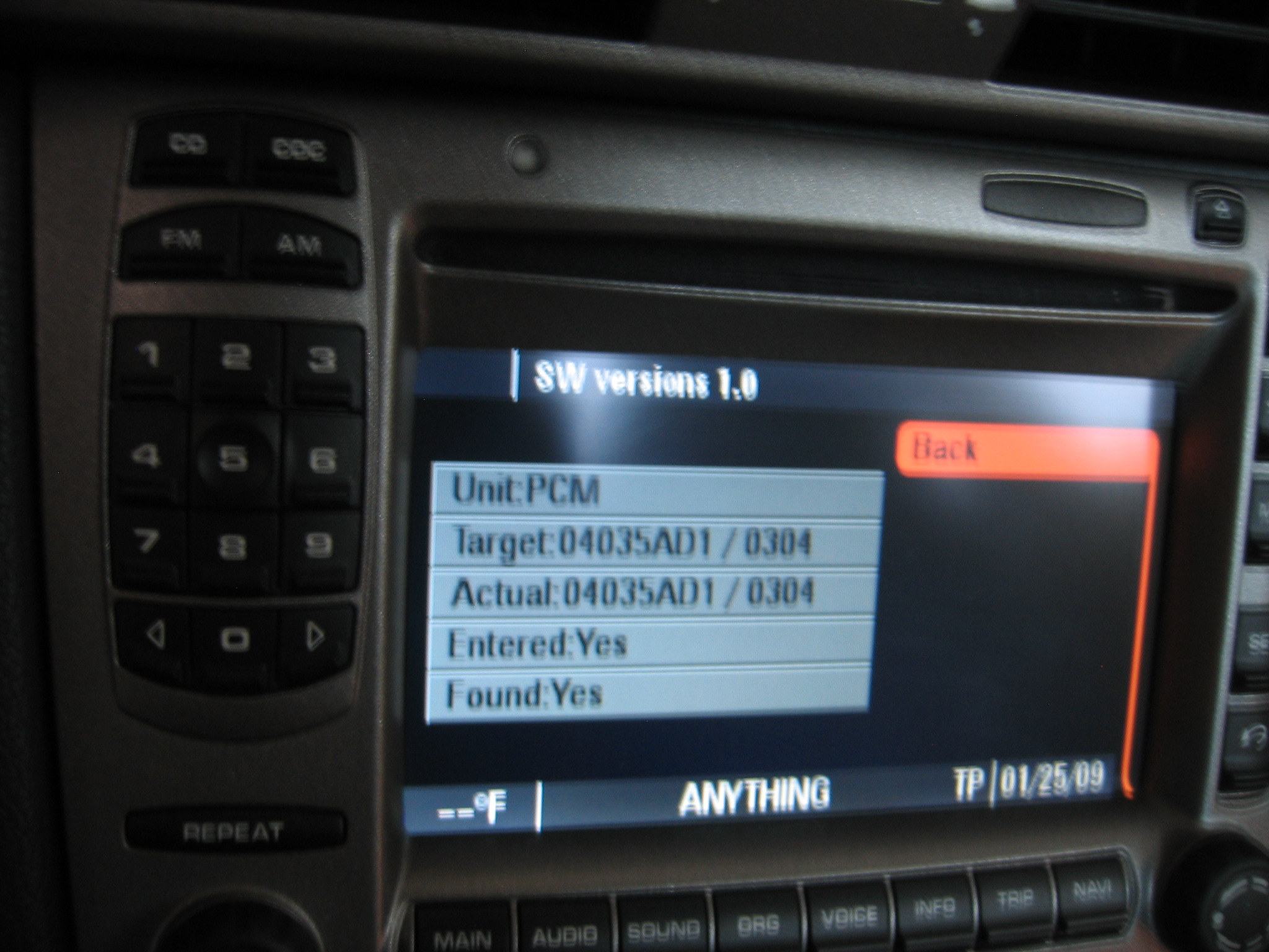

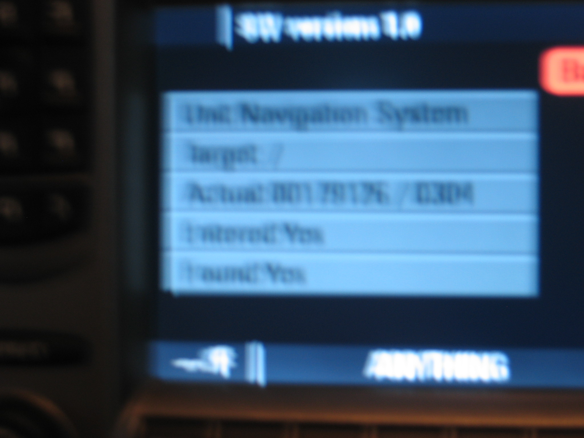

  10. Screen shots of my PCM software level. And another... Nav screen software level nav unit software

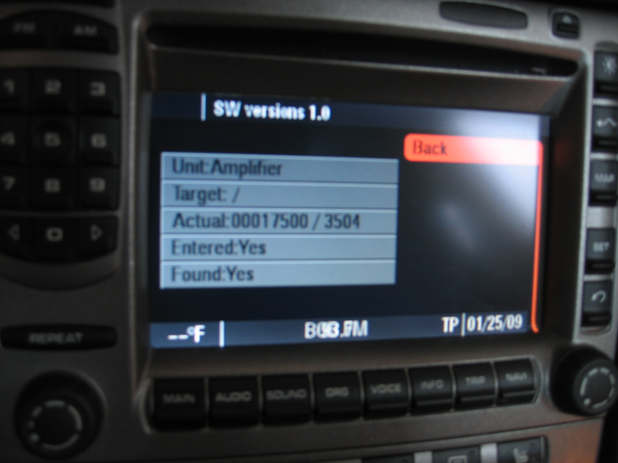

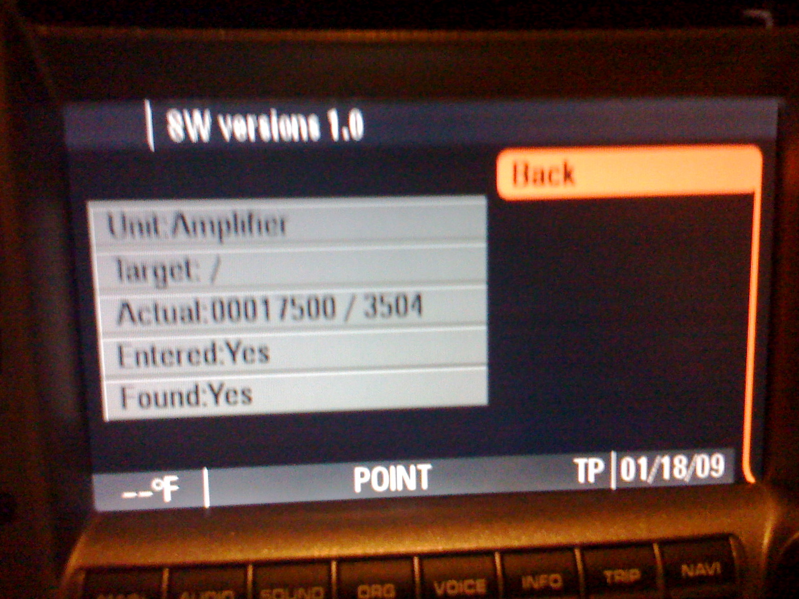

  11. You are correct the Durametric has limited programing capability (but is thousands less dollars than a PIWIS). Is the Durametric capable tp do updates to the MOST ring?
