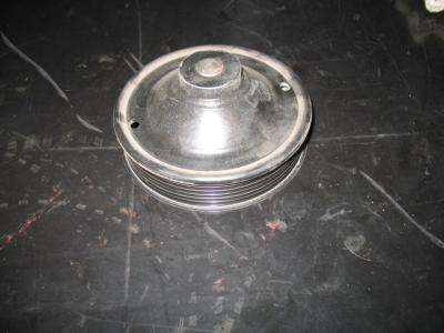

  2. Last summer a mechanic I know showed me the same thing. Until then I had never seen this happen before. The shaft for the pulley fractured. Should also have taken a picture of the pump, but here is the pulley. So now you are the second one.

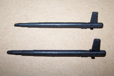

  13. Update. Guy in Canada had a mould made using an undamaged oem stem. So now you can buy replacement stems. Top is the oem. Bottom is the replacement.

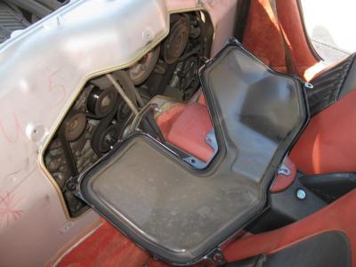

  15. Remove the service cover and check the belt that runs the alternator, power steering, and water pump.

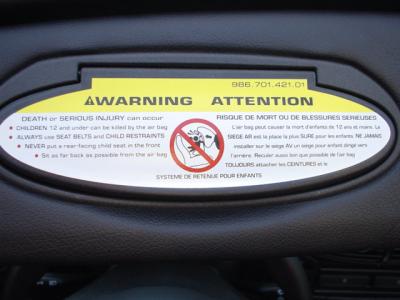

  18. Like this? Funny thing is, it is a US car, and a new car when I took the picture years ago. I noticed the warning was in French and English. Somehow a Canadian visor was put on a US car.

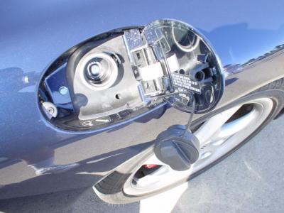

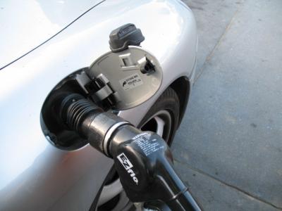

  24. The cap with the tether and hanging hook started in 2001. With that said, there was a gas cap recall several years ago. The replacement cap was the tethered style and some owners asked the dealer not to pull the tether off. If your 1999 has a tether then that is because the cap was replaced during the recall. The first pic is a 2001. The second picture is my 1997 Boxster. Prior to 2001 there were slots on the cap that you used to hand the cap on the flap. My 1997 was not subject to the recall so I have the original cap.
