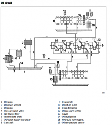

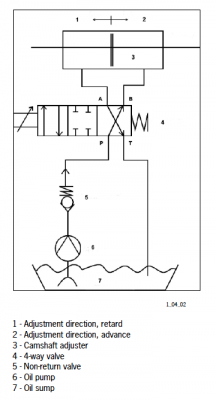

  18. Here are some diagrams of the oil circuit and the oil supply from the 4 way solenoid valve to the vane adjuster on the camshaft. Essentially the solenoid valve is a 4-way proportioning valve that connects one of the control lines ( A or B ) with pressurized oil from the feed line P and open up the other line to allow oil to flow to the crankcase. If the A line is pressurized the vane adjuster is turned to advance, if B is pressurized it retards. In the center position both lines are closed and the cam maintains its current position. Intermediate positions between A fully connected or B fully connected to P are also available allowing for slower but finer changes in cam timing. Therfore the valve controls both the speed and amount of cam timing changes in contrast to the on or off cam timing on the earlier cars. The non-return nature of the valve allows for proper cam timing changes under low oil pressure conditions such as low engine speed and/or high temperatures. Hopefully, these diagrams don't violate copyright issues on the site as they are taken from Porsche technical publications. If they do I apologize to Loren and feel free to remove them. -Todd
