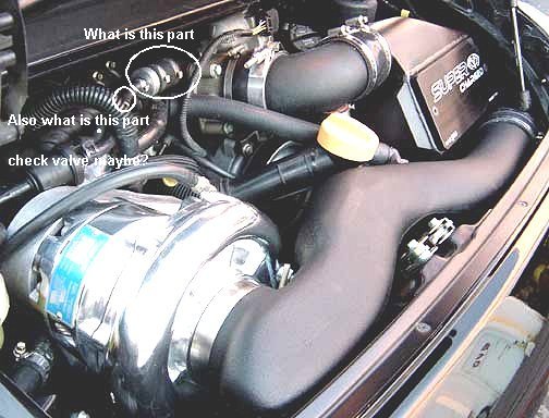

  6. I can not find these parts in my manual are! One looks like a filter and the other one just upstream looks like a check valve?
