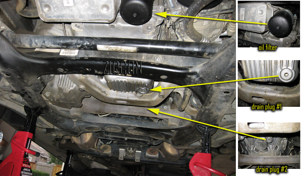

  12. nobody posted pictures for these so called DIY's, I'll upload some pictures 2004 cayenne S, I just took off the bottom covers and my filter is in the front it doesn't have any screws or bolt on it. The casing is black plastic. All the previous posts referred to having to loosen up a screw to remove the filter. could it be that on the old models the oil filter casing doesn't have a screw?.. I'll post a picture in a minute I'm hoping for a quick reply to whether I can go ahead and remove the plastic casing just by hand instead (no bolts / screws are there to remove) I have not completed the oil change yet I just took the underbody plastic covers below are pictures of the car. I want to confirm how to remove the oil filter and the correct drain plugs to use better safe than sorry. Steps 1. Lift car or put on Ramps (in either case make sure to use STANDS as well!!! do not trust your jack or ramps alone), put foot brake on, and put stoppers on the rear wheels (pieces of a 2x4 would do) 2. Remove underbody plastic covers you will need (TORX 25 / 30 / Phillips screwdriver) 3. Remove filter casing / Remove oil filter / drain filter oil (as someone posted it's a good idea to put a plastic ziplock bag on the filter before removing it) 4. Put new filter back on / put O ring and lube with some oil / Tighten filter casing (Got filter from pelicanparts.com I think $13.00) 5. Remove drain plug #1 6. Remove drain plug #2 7. put back drain plugs #1, #2 8. Fill car with 0w-40 Mobil1 Synthetic Oil (Got mine from walmart at $6.25 / Qt, please post sources as this is the cheapest I was able to find) 9. Remove stops from rear wheels, remove foot brake, remove ramps / unjack the car 10. park car in a leveled surface and let sit for a minute. Check the oil level on the dipstick add oil if necessary. 11. Run the car for 3 minutes let sit for a minute, check the oil level again and check the car for leaks 12. Put car back on ramps and put underbody plastic covers You're done :)

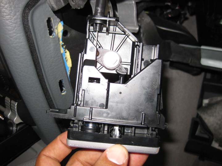

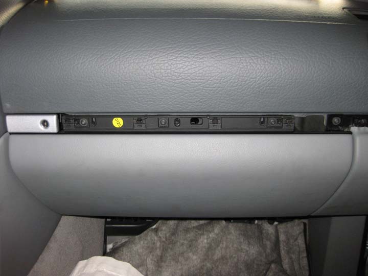

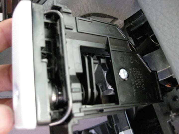

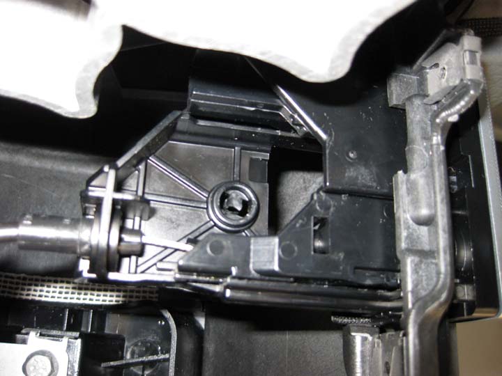

  13. To answer my own question, the answer is kind of silly. The reason the handle (tab) would not slide down because I had the glove box on the locked position so what was sticking out is the locking prong for the locking mechanism. The solution was to put the key in there turn it to unlock position and I was able to slide the whole handle for the glove box. The problem was cause by a little piece of plastic that acts as the pivot point as the previous poser mentioned, this is a weak design and will fail in most cases. I ended up doing the same fix I drilled a smooth hole to fit a screw in there. I put a washer to allow for movement and an extra nut so the screw won't come loose. I'm posting some picture DIY: You need a T20 torx bit 1. Remove the Trim (in my case it's titanium silver trim) start from the end near the door and pull on it gently it will pop off. continue popping the rest of the tabs in the trim. I used a credit card to help it come off easily. 1.5 if your glove box is not open look for a hole in the middle of where the trim used to be. I think it's the biggest hole available. To open the compartment sit in the passenger seat facing the glove box, put in a screw driver in the big hole at a 45 degree angle pointing downward and to the left. press gently toward the console (like if you were checking if a steak was done don't press too hard as there are other plastic parts that might break) 2. To remove the box there are 3 screws behind the trim that you have to remove. it's Torx 20, there is an additional screw next to the lock of the glove box, and two more screws that are now visible on each side the open glove box, they are inside rubber guards. 3. Look at the bottom of the glove box, there is a screw in the middle that's holding a black plastic cover. Remove that screw and pull the black cover from each end it will snap loose 4. After you remove the black cover there are two more screws that are now visible you can take those off 5. Now slide the glove box off gently rock it side to side while pulling it will come off. be careful not to pull it all the way out there are some wires and the ac tubing attached to the glove box. You can leave those there and rest it on something or you can remove the wires and the tube and put them back on later (that's what I did) 6. Make sure your glove box is on the unloked position !!!! slide out the tab that has the lock where the key is used to lock / unlock. 7. If you are lucky you will have the plastic tab that would have fallen down when the plastic pivot broke. The plastic tab hooks into the wiring that goes to the locking mechanism that holds the latch. 8. All you got to do now is position it back in the middle and put in a screw where the plastic pivot used to be. add a washer and tighten with a nut You're ready to go. go inside brag to the wife a bit and have a cold one. Sorry if this is too long but I rather post as much info than have you curse me when you have the thing open and can't figure out a step. Good luck!
  14. I was able to open the glove box and took it off, then took off the prong mechanism that is used to keep the glove box closed. I'm not able to get the part where the key goes in the glove bock locking mechanism. There seems to be a piece sticking out upward from behind it's not letting me slide the whole thing out. My problem is with the plastic mechanism behind the little tab where the key to unlock the glove box goes. I have to slide that part out to inspect it and see how to fix it. I've been at it for 40 minutes in 90 degree heat (in the shade) and the stupid thing wont come off. I don't want to break it. can someone post a diagram or instructions how to pull that button (tab) that is used to open the glove box. THanks
