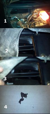

  2. Well, it definitely was an unusual problem causing the noise! I'm happy to report that Renntech helped me FIX this issue! Thanks 1schoir! After reading your post I did a lot of research looking for information on blower, fan, blower motor.I felt it was the blower motor since it got louder and softer as I turned the velocity of air up and down. I eventually came upon a bunch of posts dealing with foam getting stuck in the blower motor, here are a few choice selections: http://www.renntech....lap-flap-noise/ http://www.renntech....nside-the-dash/ I even found a pic of the blower motor: http://www.pelicanpa...tion_red_on.GIF I thought I had the same issue as the other posters and there was foam stuck on the squirrel cage, so I took apart the pieces under the front hood on the passenger side. First I revealed the cabin air filter, then I removed it, and I saw the squirrel cage. I took some pics along the way. For anyone else like me who comes along and is having this issue, here's what the pictures represent and how to check this: 1. Top/right in front of the passenger dash is where you find the pollen filter. It's easy, open the hood, take off the plastic pieces / grill protecting the top using a wrench 2. You will see the area where the cabin filter is, it's easy to remove (already removed in this pic) just gently slide the cabin air filter out from the slot 3. Deep inside of this hole you can see the squirrel cage that matches the pelican parts pic I linked above. It's down through the hole past a large plastic flap 4. You can turn the cage to inspect the blades. You can see in pic 4 a dark mass on the blades, THAT is what was causing all of the noise! Instead of finding a piece of foam in there as I suspected, I actually found a piece of electrical tape that was stuck pretty tight to 5 of the blower cage blades. I have no idea how that got in there past the pollen filter but it did! As soon as I pulled the tape out I was good to go! If you find something in there and plan to pull it out, as others have said in different posts, make sure the car is off and the fan is not running before you stick you hand down there! So Richard you were dead on with the cause as well. Any ideas on how a piece of electrical tape could have found a way into this area?
