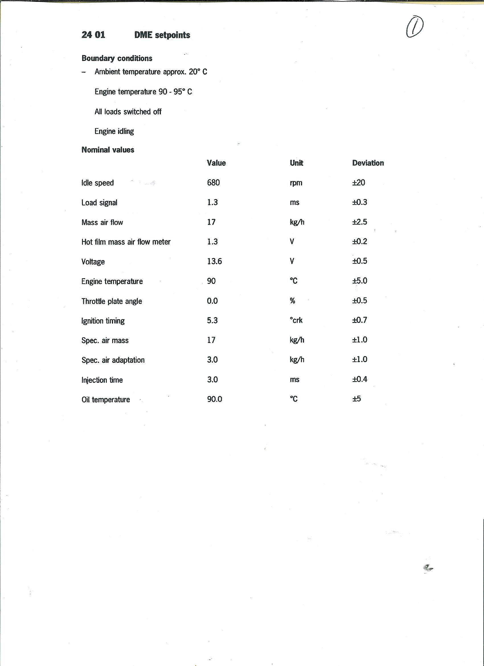

  14. Here are the DME set points for your car. Howard c337cc - this is very good info to have on hand.. do you know where i can get the DME set points for my model-year 2003 996 C4S 6-sp ? rrspike I have that info only in mode 6 form,if that will help. Howard

  20. Here are the DME set points for your car. Howard
