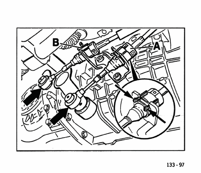

  15. I wonder if the problem may be under the car, on the transmission driver side near the rear wheels. The cables connect to a linkage, and have two places they could come loose, first the spring clip that connects to the linkage, then the ball that connects to the linkage. Here is a diagram, you have to remove the rear cover to see them, but if they are loose or off, it will be obvious.
