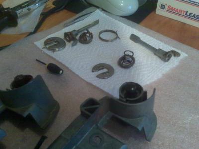

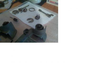

  7. This is harder than replacing the Hydraulic cylinder. I would suggest to remove the door panel first before doing any purchase. Here is a link at ebay. http://cgi.ebay.com/ebaymotors/Porsche-911-Carrera-996-Boxster-986-Door-Lock-Cylinder-_W0QQcmdZViewItemQQfitsZMakeQ3aPorscheQQitemZ250687244727QQptZMotorsQ5fCarQ5fTruckQ5fPartsQ5fAccessories You have to remove the inner door panel first. Steps includes removing several screws that hold the handle, pile out the a few plastic one that goes around the door. Then, disconnect the door cable and side airbag connector. Once you take the panel off, you can get reach to 2 nuts that hold the door handles. You will then be able to judge why the door mechism is working or not. In my case, I turn the key, but the lever was not moving. Removed the 2 nuts and take the door lock assembly out. The picture was after disassembling the door lock. It took me about 5-6 hours to do that, on and off. If I do that again, my guess would be about 2hours max.

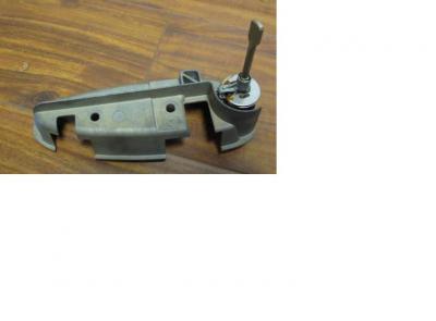

  9. My P car has the same year and model as yours. Same problem appeared as few months back just like what you have described Remote fob died and no resistance on door lock. Search thru. internet, no solution found. So I took the door panel off, removed the handle , disassembled the lock mechanism, and found a broken part . Spend $35 on ebay with a used lock and replaced that single part. Here is what it looks like.

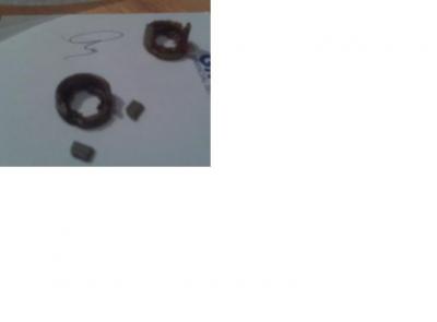

  17. Problem fixed ! After removing the door panel and took out the key lock mechanism, I found 2 pieces of small metals. Disassembled the key lock cyclinder and found the broken part. Ordered an used one from ebay and reinstall it. The door can lock and unlock without a problem now. If you have similar issue ( key lock no resistance ), very likely is the same broken part in the picture attached. The linkage seems pretty strong to me. Hope this help other members.
