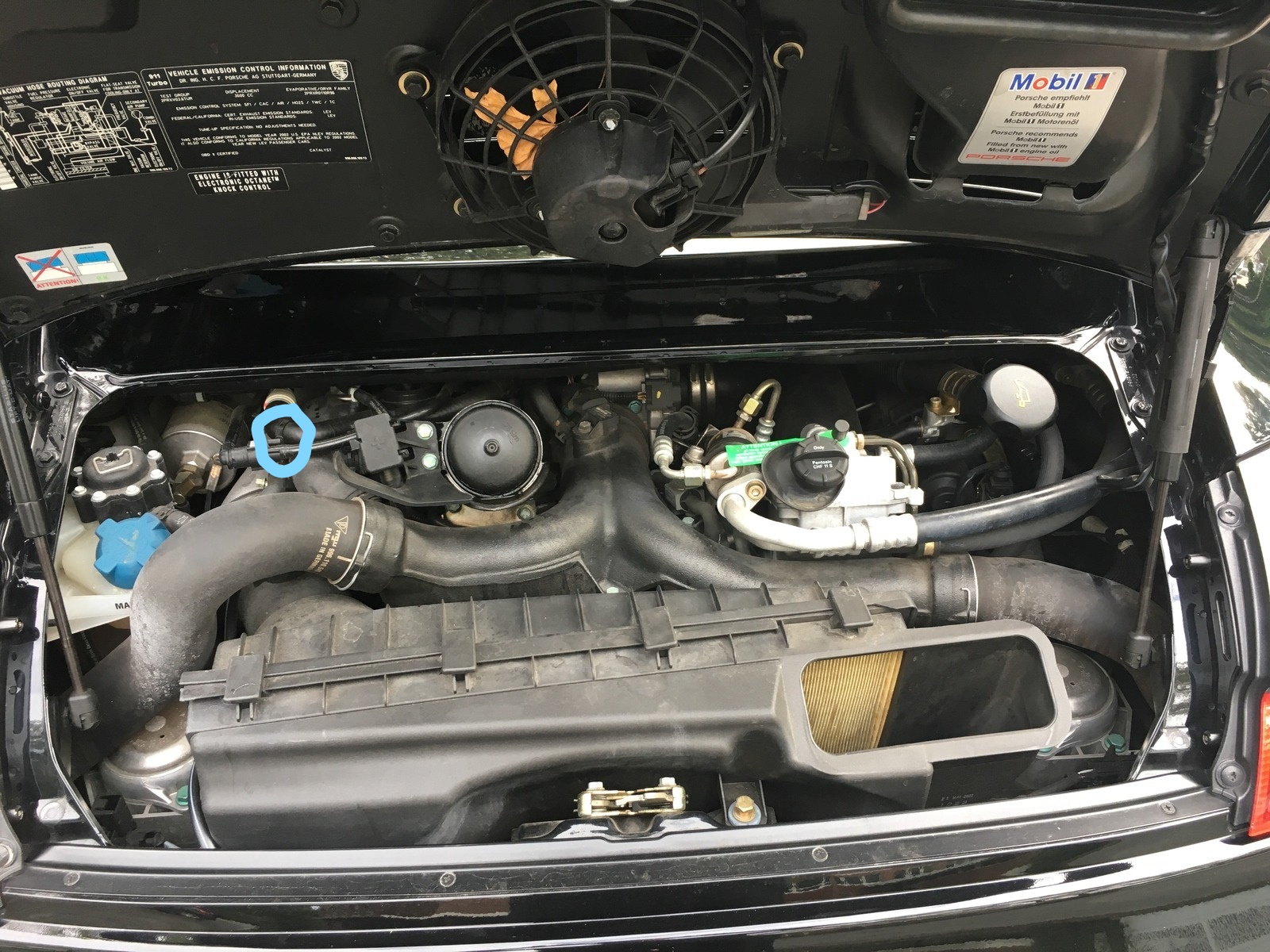

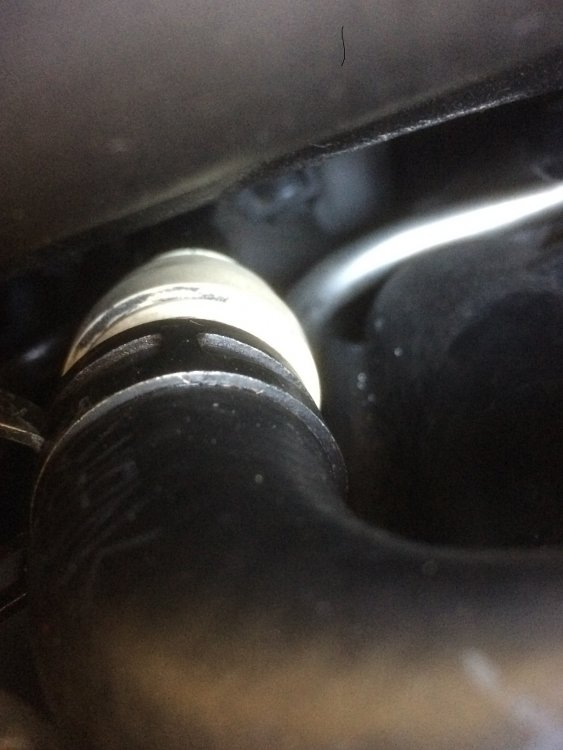

  14. It's actually attaching to the larger hose (brake booster) via an integrated cable tie. 999 507 544 40 is the one that holds the MAF cable ( I have a few of those). This cable holder attaches to the brake booster hose with a cable tie. Another vacuum line rests in the cable holder cradle. Here is a better picture.
  15. Need help to identify P/N for 2003 TT hose clip/anchor circled in blue that attaches a vacuum line to the brake booster line. Thanks!
  16. Loren, I believe it is the black plastic brake booster vacuum line. The white piece in the picture is a coupler that fastens the hose nipple to it. I am trying find the PN for the line. Thanks!
  17. Thanks jflip. So this is a vacuum line for the brake booster? I was replacing the rubber hose that attaches to this fitting when it came apart. I didn't remove the clip. Now, the hose nipple doesn't seem to fit in the fitting as well as before, (can slide nipple in and out 1/4") so maybe I damaged the fitting. I sprayed soapy water around the fitting, with the engine running and didn't detect any leaks. The brakes seem to work fine. What do you think? I doubt if the fitting is replaceable. Thanks!
  18. Hi Loren, There is a hose that is called Hose Throttle 996-110-654-73 that originates from the intake plenum through a Y fitting, then plugs into a white connector/plastic black pipe through the Socket Fitting P/N 99611065770 that goes to the rear of the engine on the left side. I am not sure where that line terminates. I was replacing the Hose Throttle 996-110-654-73 and was trying to disconnect the Socket Fitting , when the Socket Fitting abruptly came out of the white fitting. Now the Socket Fitting is not as secure in the white fitting, as it was before I messed with it. I checked for leaks at the fitting, but didn't detect any. Nevertheless, I am concerned that it is not a secure fit. PET only shows the Socket Fitting throttle hose P/N 99611065770, but doesn't show the fitting/line where it connects. Here is a better picture. Circled in blue is what I am talking about. I believe the white fitting is called a push-fit. Thanks!
  19. MY2003 TT I am trying to find out the P/N for this white fitting that attaches to the Socket Fitting throttle hose P/N 99611065770. This is on the left rear side of the engine. PET doesn't show the line or fitting. Thanks!
  20. Thanks! It is working now, after I re-seated the 3 connector plugs.
