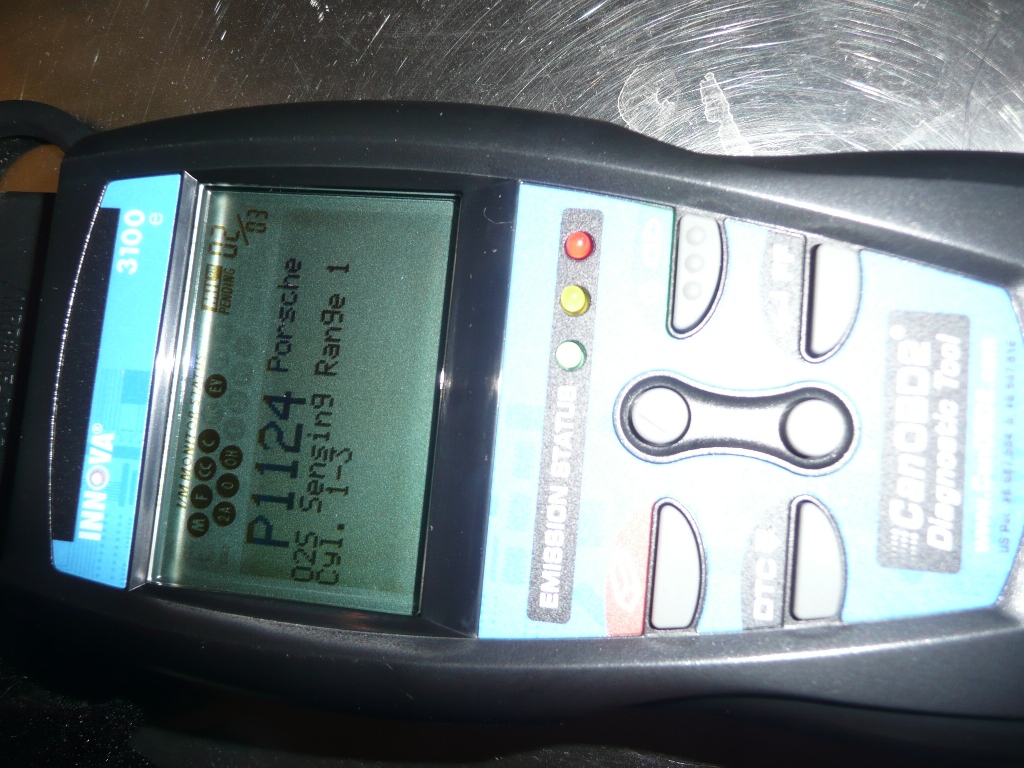

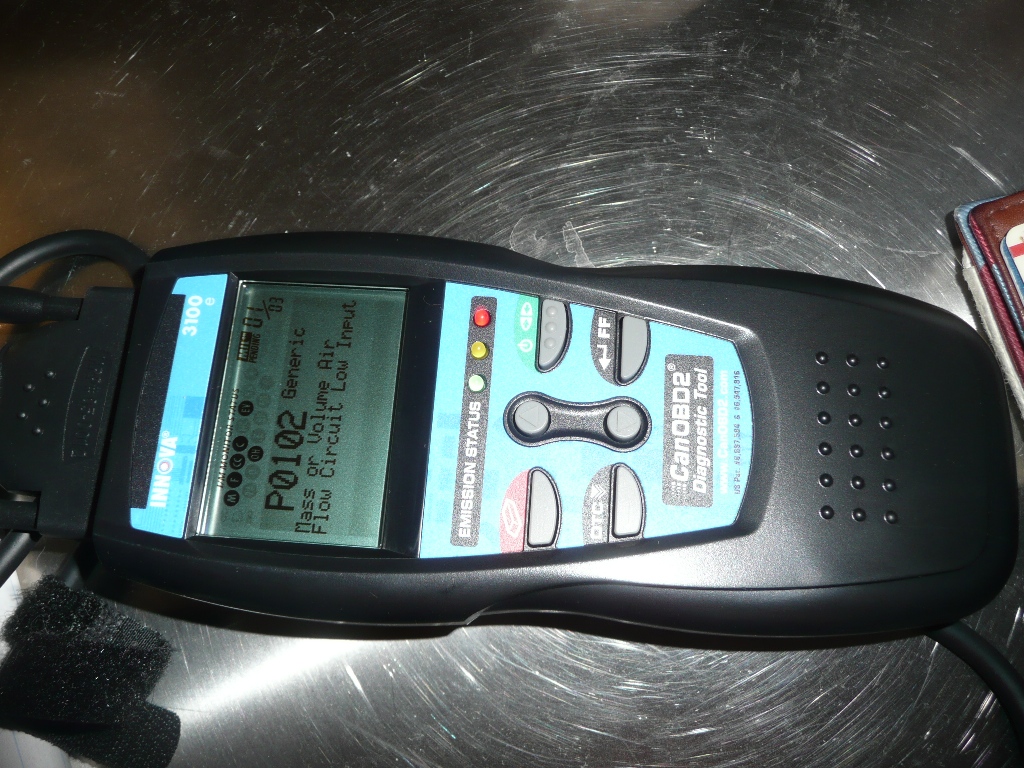

  2. I've just bought an ainnova 3100 diagnostic reader from amazon for $89.00 (which i thought was a bargain price) as I've been having a few issues with my 97' Boxster and wanted to become less dependant on taking her to the tech each time. So I've recently had the pre cat O2 sensor replaced on the drivers side, but its still idling rough, so i plugged in the new meter and got the following codes: P0102 - mass or volume air flow circuit low input P1124 - O2S sensing range 1 cyl 1-3 P1126 - O2S Sensing range 1 cyl 4-6 I'm going to clean the MAF sensor first, and see if this then balances the O2 readings - my assumption being that if the MAF is giving bad readings it will result in the O2 sensors results not being what the comp thought they should be based on the MAF (false) readings? Any suggestions guys.

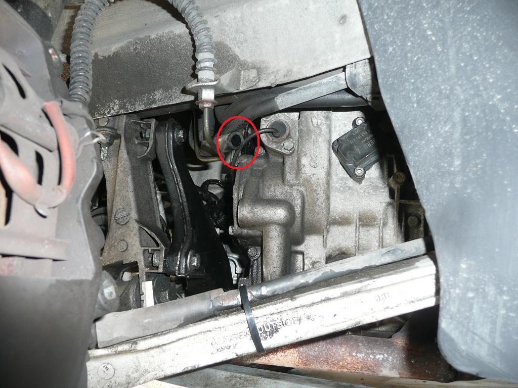

  13. Hey guys, bad news for me, I think my transmission just went out. 1997 Boxster 2.5 Trip. Gears were slipping, turned around and went home (4-6mins), got there just in time to get no traction in gear, and dump a load of oil. Pic attched is of the belly, and the pink 'think' that was in the oil. Does anyone recognise this part, I haven't called the garage yet, but I am guessing this is a total transmissioon failure. Anyone have any advice?
