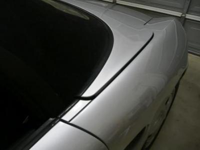

  19. Thanks Maurice, very helpful. Can you see that the plane the disk behind the V-rod is on is not vertical, it leans out (to the right on the pic) at the top and in at the bottom, I assume I'll need to straighten this? Motor cables will need to be replaced I think, the piece that extends into the motor seems to have snapped. Roof is another issue, goes easy to about 1 inch from engaging, then gets real stiff. I wondered if it might have shrunk a little (who knows how long it has been folded up under the Hard top?), once it is up it all looks aligned, i've left it 'up' to see if it'll streach out some. Also with the soft top uo, the clam shell sits 2/8 - 3/8 inch high on the left side, fouled by the rear of the hood? Thansks, too many questions I know! If I get to NY I'll buy you some beers for sure!

  21. Ok, I will. The soft top goes up, but takes some pulling to get it to lock to the windscreen frame, more than the motor would provide I am sure. Whilst the Carfax states no accident damage, I have to think that something has happened to the right side? how else could these parts have been bent? I can't really cpmplain, I got a good lump off the sticker price for the roof 'not working' and it has a removable hard top too (I just like to have things working!) I'll post pics later. Thanks
  22. Hey thanks, wow, sounds like just the smae issue. I took the vent off yesterday to get a good look behind the transmission as it looked like the metal had been stressed. I have some pics of the transmission side but neglected to take any through the air intake (though taking it off is a 2 min job, i'll do some this evening). The sheet metal has been twisted, you can see where it has 'folded' or creased. there is a Triangular 'frame' bolted on the inside and it too is slightly bent. No rips or tears in the metal though, so I was considering whether a body shop might be able to 'bend/hammer' it back into line. Other than that, and a few replacements for a broken 'v' bar (not sure what that is called) I think the hood will work ok. I'll get some pictures on tonight. Thanks again for your help Maurice. Andy
