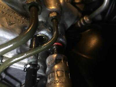

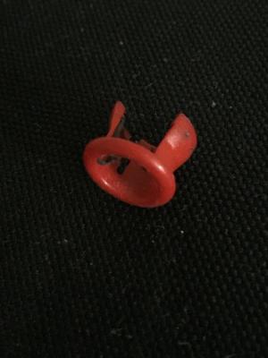

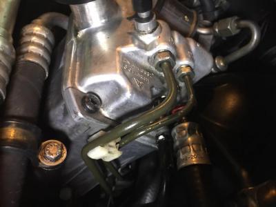

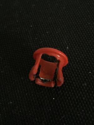

  1. I discovered a leak on the power steering reservoir of my 996tt. It was caused by a broken grommet. I need help to find a grommet like in the picture below. Can anybody give the part number of this red grommet or where can I get a replacement. Thank you.
