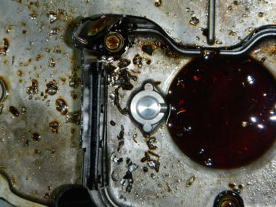

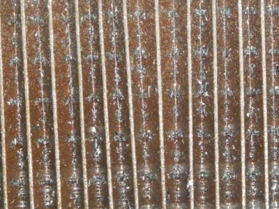

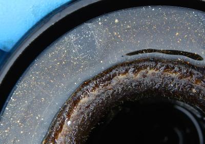

  4. Pictures as requested. Pulled oil sump cover- lots of shiny bits, and a picture of the oil filter.
  5. As it turns out the problem does appear to be a mechanical fault. After finding no wiring issues, i went back to the basics and started with looking at the oil. I had checked the dipstick but it was clear. However, the filter seems to be clogged with bits of bearing shavings. Last question that i have before i start investigating replacement engines -- knowing that the engine shot craps, is the Tip fault code noise, or is it possible that the Tip and the engine both failed (maybe one contributing to the other?) Thanks for the help and great ideas!
