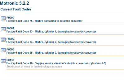

  9. Alright i was lucky i had the cable in my car and was able to find the software - looks like the 02 sensor on the back is bad? how is that possilbe it has just been replaced?
  10. All I need your advice, i have a history with my MY97 2.5, i had regular problems with my CEL turning on and I got teh 1126 ( running lean / rich ) or problems with my oxygen sensors before and after cat, and i had some problems with oil leakage on the engine... I replaced the AOS ( with the .. 04 model ) replaced al my O2 sensors and air sensor.. When i replaced the AOS last week my car stopped leaking oil which is great news, however it did not resolve my issue as the CEL came back on after 300 miles...but this is what happend today !! I am driving up north about 400 miles (my sisters house) and when I was almost there I did a few over-takes with high RPM's after this, my car didnt want to accelerate and it almost stalled when driving it, when i released the accelerator it stalled when going idle and i had to keep it on 2000 rpm to keep it running, also at this time the CEL was blinking and i lost all acceleration power.., I pulled over and reset the computer by disconnecting the battery but that didnt resolve the issue, although it is now running idle again but very rough and not shutting down.. the CEL is now blinking on off sometimes it does it and sometimes it just is " normally " on and at least i have some acceleration again ... My question as I dont have any tools with me, can i keep driving it back home (400 miles) ? it seems to be handeling pretty normal again (at least driveable) but i am afraid of the blinking CEL which appeared earlier..

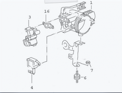

  11. Does anyone knows the part number of th gasket ( # 16 ) Is there also a database where all part numbers are easy to be found?
