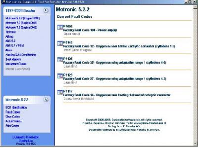

  9. Alright i was lucky i had the cable in my car and was able to find the software - looks like the 02 sensor on the back is bad? how is that possilbe it has just been replaced?

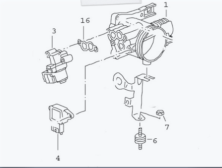

  11. Does anyone knows the part number of th gasket ( # 16 ) Is there also a database where all part numbers are easy to be found?

  19. Guys my MY 97 boxster was i thought fault free after replacing all of my o2 sensors with new (Bosch) ones, replaced the MAF just starting driving it again and again I get the CEL ... any idea's? codes p0140, p1125, p1123 and p1117 ..its driving me crazy!! Also i just opende up my engine compartment and i saw oil ON TOP of the engine, how is this possible? I know the dealer replaced my oil return hose but is this broken again or is this to less info to diagnose this? I know i have to replace my IMS or RMS already...nightmare!
