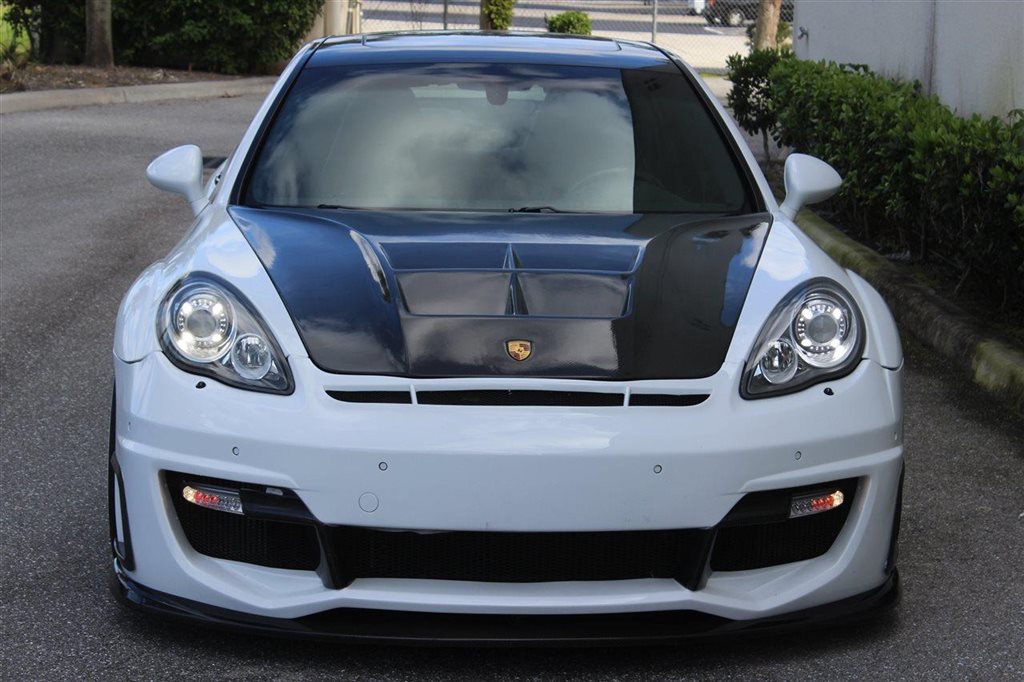

  2. i have a 2010 panamera with after market hood; have already replaced the front hood release prior; if i try to pull lever in cabin its solid with pressure and only goes back half way; i do not think the cable is broken or has come out of the handle in the cabin is there anyway to release the hood going through the lower mesh or maybe running a screw driver or something in voids/gap of hood have attached a couple pics any help or direction would be appreciated thank you

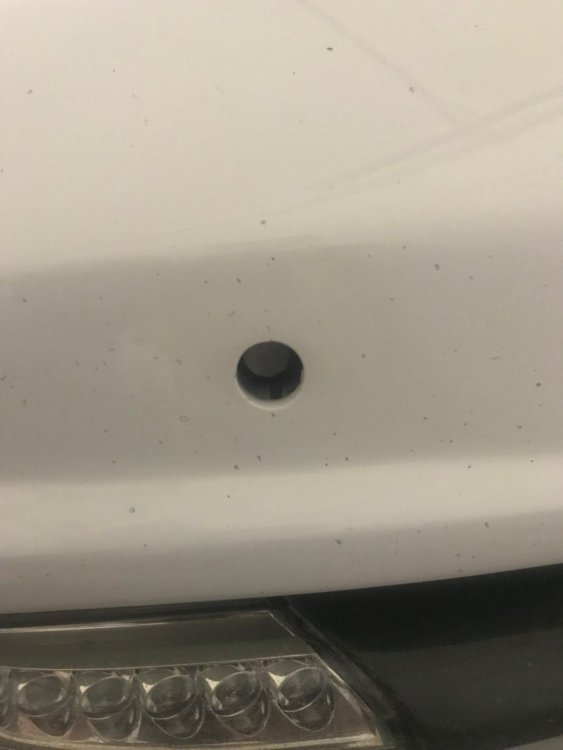

  3. does anyone know if possible to pull out or adjust one parking sensor that is pushed in on the front bumper is there any suction tool or idea to pull it flush out again thank you
