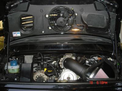

  6. Here is some more information on this: I moved the smog pump by using the bracket that comes with an EVO air intake kit. I was able to secure one of these from the local shop: "Imagine Auto". It was the last one they had. It looks like this: (the factory bracket is on the left) This moved the air/smog pump out of the way like this: Then I cut a section out of the airbox and used Bondo to seal it up. (I am not very good with Bondo.) Then, when I wasn't real happy with my bondo job, I bought an EVO induction kit and put it in there: (The problem with this is that I don't like the way the EVO sounds, so I'll probably change back to the bad bondo airbox.

  10. It was a tough job, but I made it work. For starters, the decklid fits on the car, but it won't close due to the "pistons" that push up the spoiler at 75 mph. See other details here: Discussion about making airbox work It required the following modifications: 1) Move the air pump (aka smog pump) 2) Cut out part of and re-seal the airbox 3) Cut a new hole for air intake in the underplate of the turbo decklid 4) Seal the turbo air intake hole in the underplate of the turbo decklid 5) $50 for the new "badge" Yes, I realize that I now have two center brakelights and it does look a little funny, but only the spoiler one lights up when I push the brake pedal.

  18. Yes and no. I got it on the car and it fits on the car just fine. When you close it the two struts that are the hydraulic device that push up the wing (at 75 mph) hit the airbox on the right side and the smog pump on the left side. Moving the smog pump is easy. I found a bracket that goes with the EVO intake that moves the smog pump. I couldn't figure out if a GT3 or turbo have a smog pump, but that bracket might work also. Getting the airbox out of the way is tough. I think that I am going to buy an extra airbox and cut the corner off of it in such a way that I can still seal it up. Then there are three other problems: -The fan seems like it is going to rub on the intake rubber tube. -I will need to cover the hole that was the Turbo intake hole. -I will need to make a new hole for the C4S intake.
