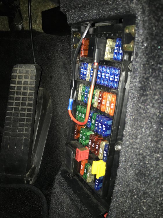

  10. My setup, from the fuse box as my car does have a phone and different connector - also mine is not a US car

  12. Success!! Now you reverse in confidence all weekend long. I didn't realise that the whole reversing system was shot until I almost crash onto a wall when reversing. I have reversing sensors and have always been depending on it to tell me how much space I've got left.
  13. This is the 'hack' in MFS that you'll need to do: Reverse light switch on tiptronic trans? - Rennlist Discussion Forums At least you had removed the center console, the second time would be easier and faster (usually).
