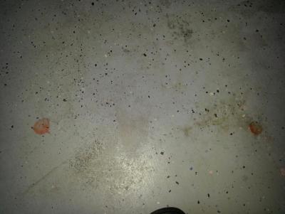

  5. It was coolant, Maurice. :thankyou: What was interesting was that within a day after I posted the spills, I got a CEL with a P0455. I strongly suspected the aftermarket fuel cap, replaced it with an OE one and erased the CEL. So far no CEL or these spills. I have a new coolant tank as of a year ago and no spillage of any sort until I got this aftermarket fuel cap. Could an EVAP leak cause a spillage of the coolant? or am I connecting two disparate events... Regards, Vish
  6. Will do this evening, JFP - spotted these on the way to work, so wondered if this color may be an indicator. Googling up that color - that could be transmission fluid or coolant, since I always felt oil would be darker and more viscous. But mine is a manual so transmission fluid would not be applicable or coolant since I thought it would be green. The color is more like pinkish-red. Vish
  7. Dear Porsche-mates, I noticed these two spots towards the rear of the car, as in attached, when I moved the car this morning. They seemed fresh and felt a bit viscous, though don't feel oily. The car starts with some smoke, from a very cold start, though that smoke disappears very quickly. It runs and idles fine though. The only change that was done to it before these spots showed up, was that I had to replace the OE fuel cap with an aftermarket cap from Autozone. I was unable to clear for emissions for registration with the OE cap, since it had cracks in the rubber seal and failed the equipment test. The car is a 2000 S with 134K miles on the original clutch. Clutch shifts fine. Appreciate your insights on what this could be... Cheers, Vish
