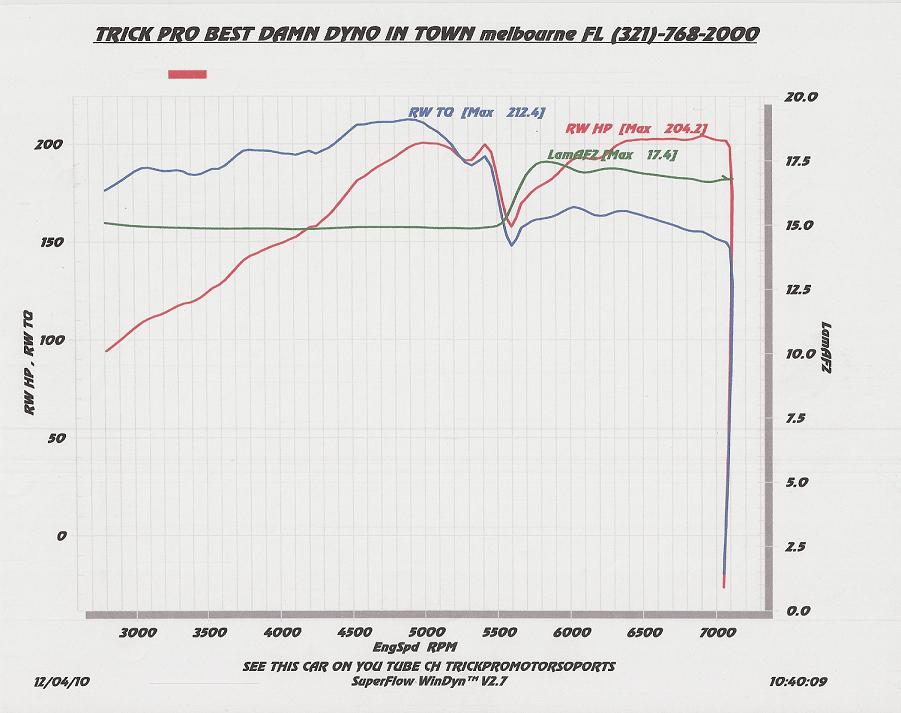

  22. I've always thought my new-to-me '99 996 had some weirdness going on around 5500 RPMs while at full throttle. It sputtered a bit when I tried to open it up in the 5k area, and then felt better again at 6k or so. I'd heard of the 'flat spot' in these engine's power curves, so I thought it was just the nature of the beast. The local Porsche club had a dyno day this morning and I got to see what's going on. Everyone confirms it's not normal. She's running lean once the revs pass 5500 (check out the lambda curve). Most peoples' guesses today were that it's the Oxygen Sensor. So far I have not run a scan on it. It feels completely normal driving around town, and seems to pull through first and second gear smoothly. Starting in 3rd gear when there's a lot of load, you can really notice the sputtering. Anyways, I'm going to try to attach the scan of the dyno chart. This is a bone stock (as far as I know) 1999 996 C2 Cabrio. Any ideas what's going on here? Thanks! Dave
