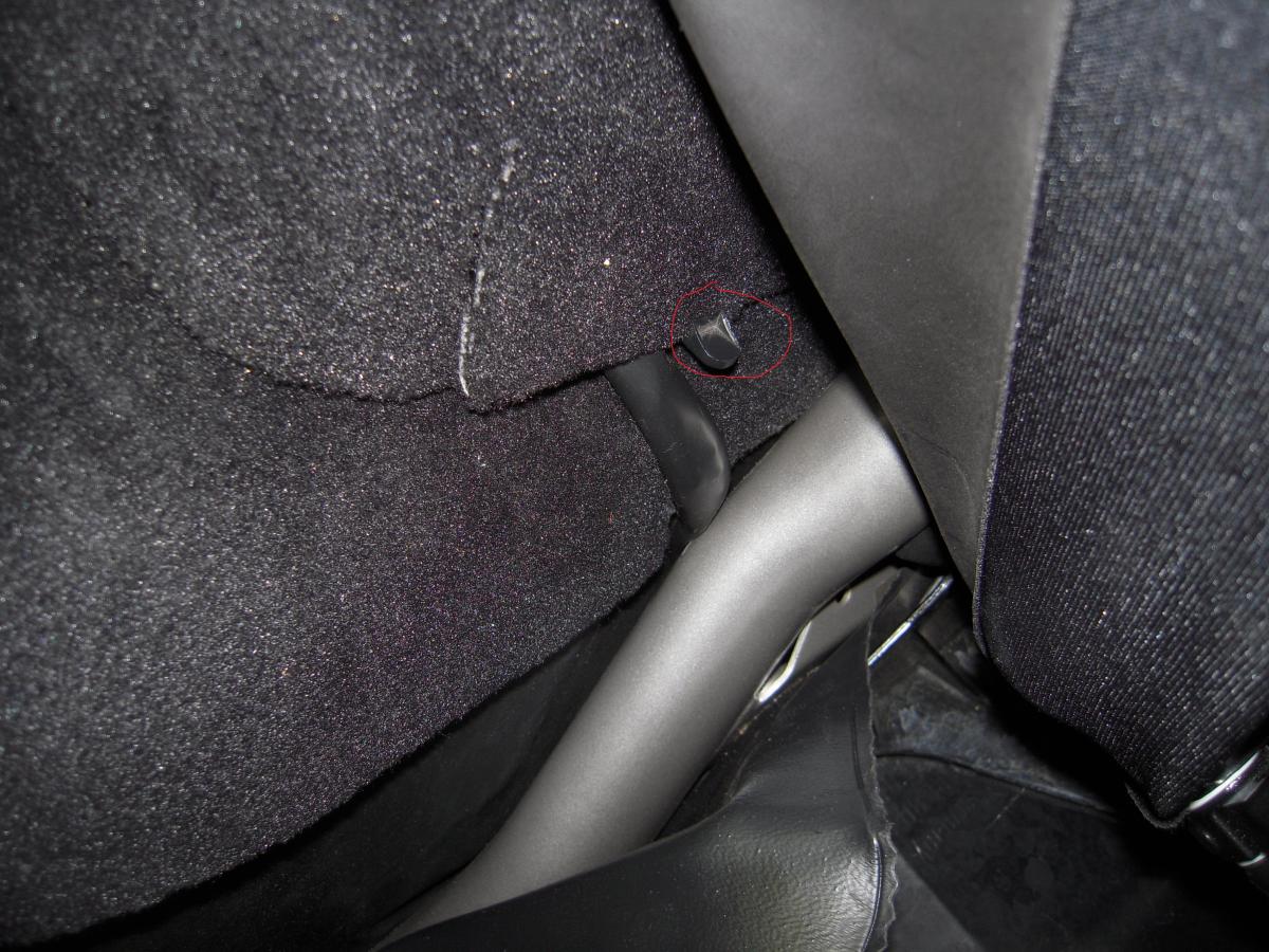

  19. Attached is a photo showing the speaker wire going behind the roll bar. If the connector is located on the other side of the roll bar shown in photo I don't see how to access it. There is absolutely no slack in the wire. I was thinking the plastic tab circled may have something to do with releasing the connector. Pushing and pulling on it has not worked.
  20. Attached is a photo showing the speaker wire going behind the roll bar. If the connector is located on the other side of the roll bar shown in photo I don't see how to access it. There is absolutely no slack in the wire. I was thinking the plastic tab circled may have something to do with releasing the connector. Pushing and pulling on it has not worked.
  21. 2011 Boxster S How do I remove electrical connection to speaker box mounted on top of engine cover? I found this site below that says press the tabs on the connector to release. I can't get my hand under the speaker box to get to the connector? http://www.pedrosgarage.com/Site_3/Accessing_the_Engine.html Without removing the speaker box i can't get the engine cover off to replace the air filter. Circled in the attached photo are the wires going to the speaker box and what appears to be a plastic tab that I haven't be able to figure out if its use in releasing the connector. Anybody have advice on how to proceed?
