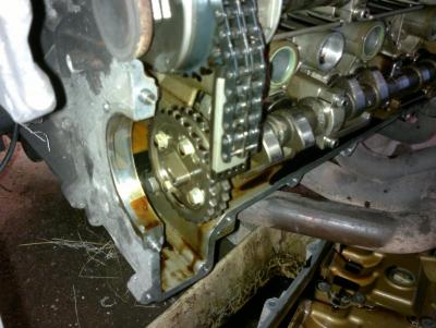

  3. Indeed it had seized the scavenger pump bank 1-3 with a piece of chain roller and this in turn snapped the chain and cracked the cam sprocket. IMS to crank pulley sheered off and 10 bent valves with 4 normal followers and 6 vario cam plus followers also required as they had dint's in them. I upgraded the IMSB and fitted loads of new parts to future proof it a little. It took me a couple of months to rebuild the engine but its all back up and running now and I'm able to enjoy the car for the last couple of months of (UK) Summer.

  6. Hi everyone. I've found this thread from searching as I've had the same problem with a snapped cam chain, I've only just started breaking the engine down to find out what had happened, this what I discovered. Marcm, what was the outcome from your engine failing, did you ever rebuild it? Would be great to know how you got on. I'm looking to rebuild myself so all help would be appreciated.
