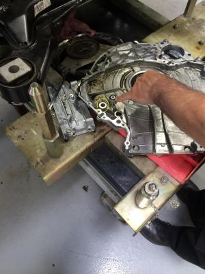

  2. Update and remedy: Ok, my CD is fixed and hopefully leak free. As noted above this was indeed an engine and transmission out job, including air suspension in the front. We replaced the bell housing cover. The explanation to PAG was the cover was slightly warped and was not providing a proper seal. Although the locktite sealant was present after removal of the cover, there was one particular area where it appeared to be a "breach" in the sealant and was the area of the leak. This is a complicated and time consuming job, but very doable for properly trained service department. Of course the bell housing cover was not available in the US so one had to come from Germany. Attached photos shows the area of leak (yellow circle) and engine timing chains with bell housing cover removed. Once the CD was put back together, I cannot tell any difference in the vehicle - engine, transmission, etc. Also I want to says thanks to Gunter and his team at Fremont Porsche for a great job and working with me through this involved process.
