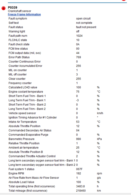

  2. Recently the Jagermobile (2006 C4S) would not start right away when warm, it would crank too long before starting or not start on the first attempt. It would eventually start, after a couple of attempts, but today it was a bit different. After starting it seemed to go into limp mode and the cruise control would not operate (No Check Engine Light). After I got home, I connected my Durametric into the OBD and found error code P0339 (see attached). I ordered a new sensor and will update the forum after I replace the suspect sensor.

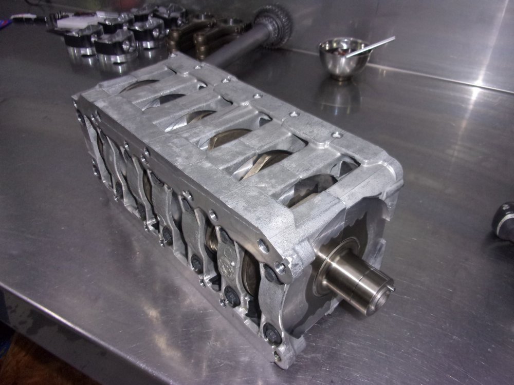

  5. Just got a message from Jake Raby... They started the motor today, all is well. Testing and tuning the rest of the week. Here are some more pictures: Notice the GT2 Throttle Body and performance Plenum.
  6. Jake sent pictures today... Assembly has started!
  7. I received a call from Jake and he said they started assembly work on the motor this week. Right on schedule with the dates he gave me back in August. Pictures coming soon.

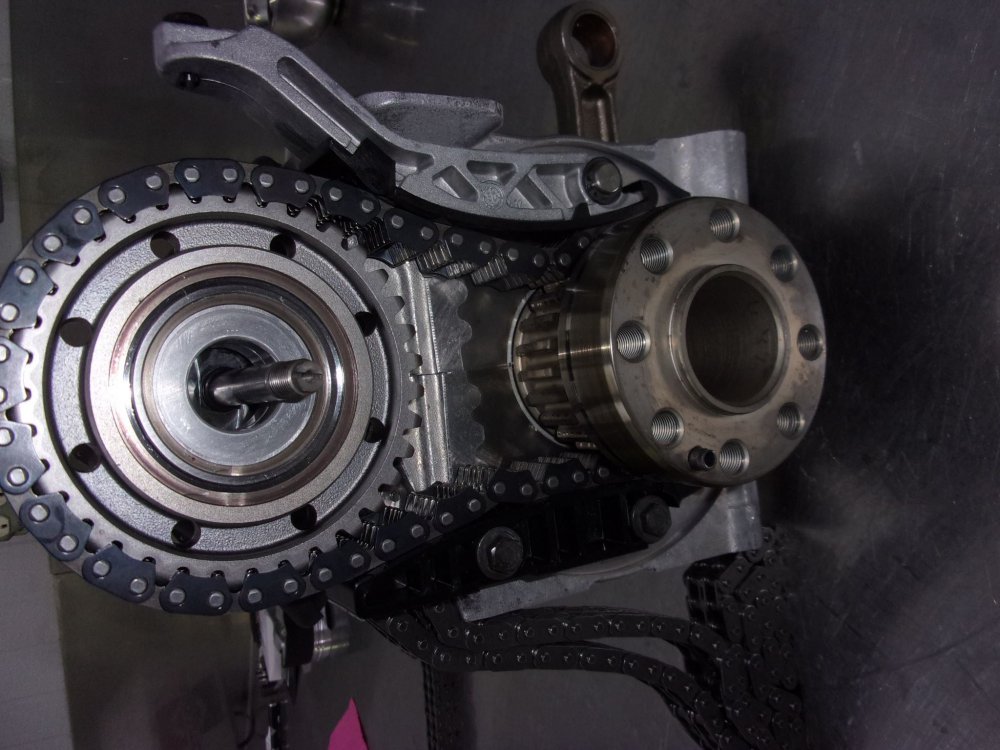

  8. 98K on the engine, no mods on the IMSB. I use Red Line 10W40 every 3K miles but I am not the original owner. I have owned this car for 3 years and put approximately 38K miles on it since I purchased. I will let you know what Jake finds... He is investigating every part of the motor.
  9. No damage to the block or heads. I am going for the full reconstruction and increasing performance to Jake's "Performer" Stage 1 motor. Jake is inspecting the failed IMS bearing and shaft very closely. This is the first 997 street car he has seen with the IMS bearing failure.
