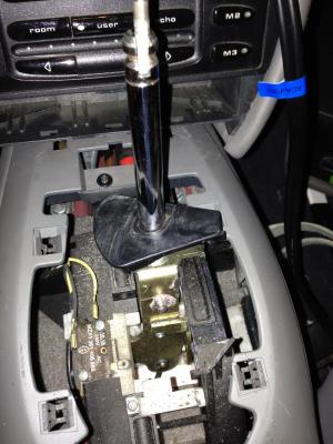

  7. 2001 996 tiptronic cabriolet (US) The tiptronic shifter started binding and getting stuck between "D" and "M" so I took it all apart and found a triangular piece of plastic with a spring attached just under the shifter gate. The spring pushes the plastic piece upward into the shifter gate trim piece (the one with the P-R-N-D-M gates). The shifter itself passes through the hole. 996-552-687-00-01C Since it caused the binding, I took it out. Does this piece have any useful function? Will I regret removing it? Many thanks!

  11. Thanks for the diagram Loren... if you could help me understand it, by confirming... The direction "3" is from P to D (toward the rear of the car)? The longest edge of the plastic is oriented so that it's perpendicular to the shifter travel, and it on the "D side" (as opposed to the "P side")? Thanks as always for your timely and authoritative responses!
  12. Ok, got the parking brake microsensor back in and I'm having some challenges getting the tiptronic shifter assembled properly. FIrst challenge was the retainer spring clip that would go all the way in. Finally I pushed it with the edge of a screwdriver and voila! it is in (30 minutes later of course) Now my problem is that the shifter clunks through the gears and is hitting an obstruction as it moves from D to M and back again. There is a funny shaped piece of black plastic with spring attached that goes right under the shifter cover. It has a hole in which the shifter shaft passes through. How does one properly orient this funny shaped piece of black plastic? Thanks...
