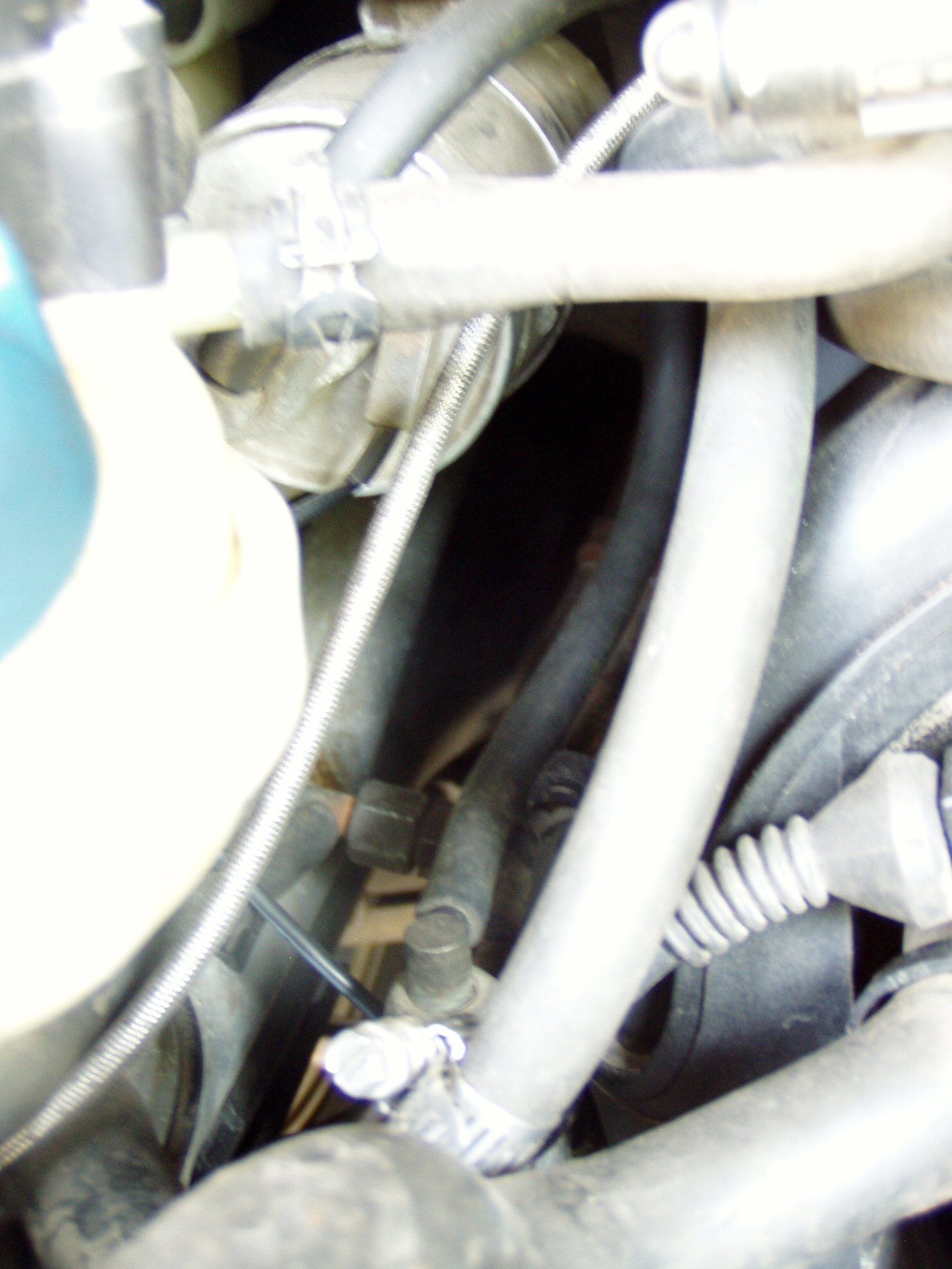

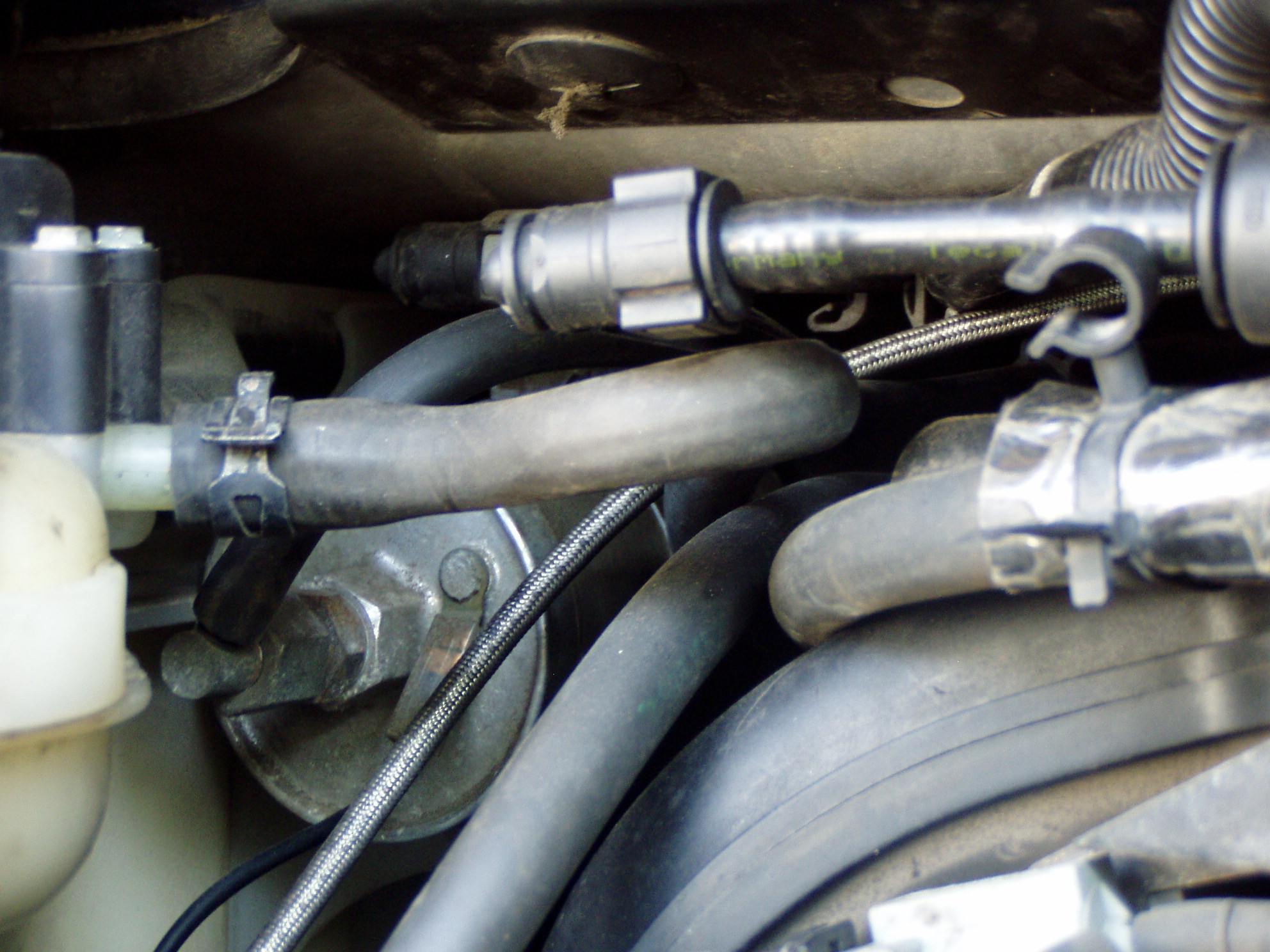

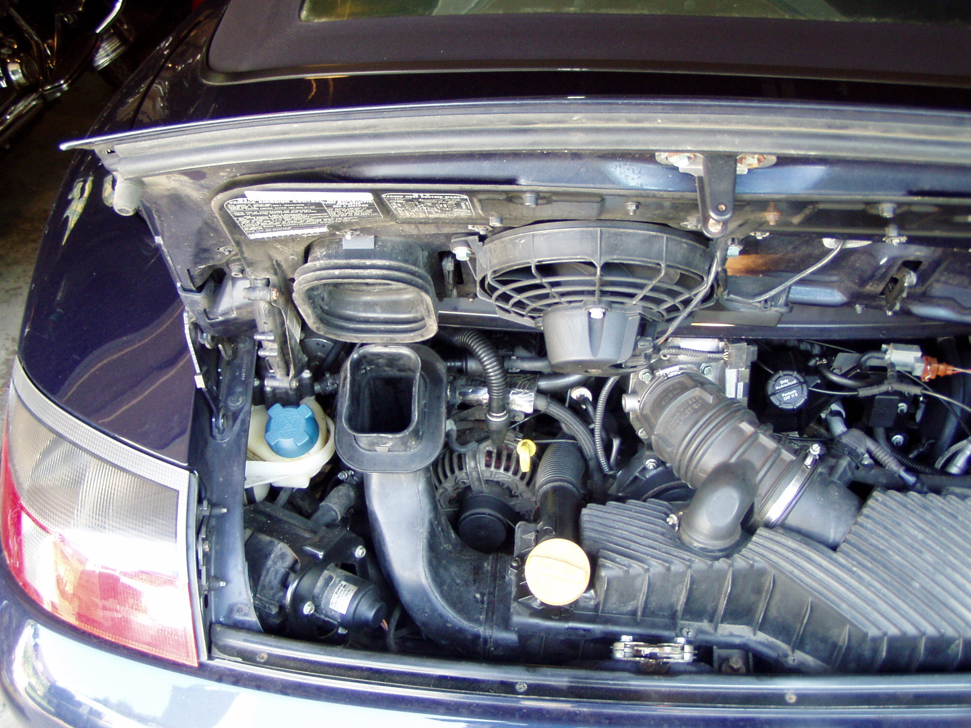

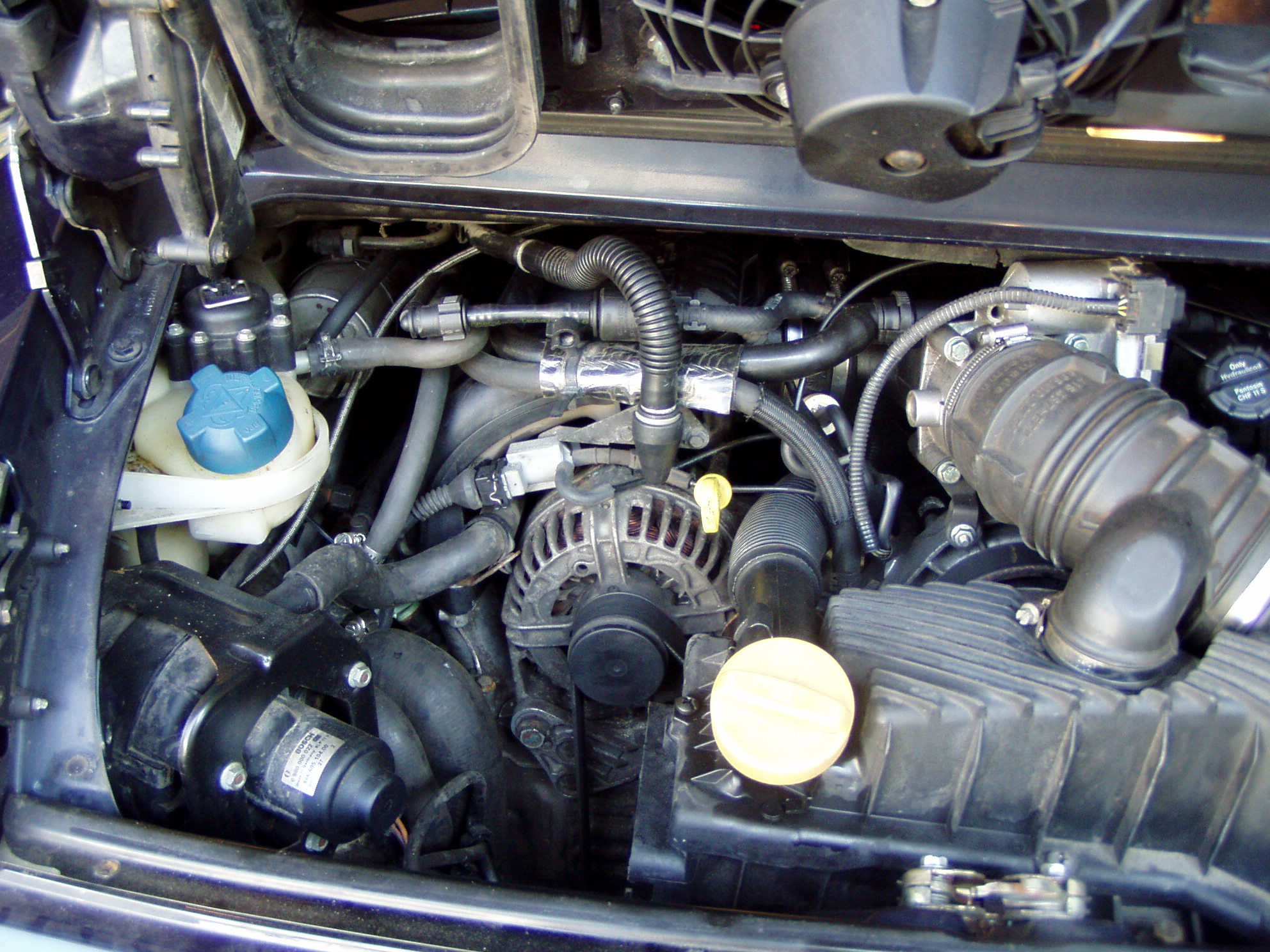

  10. Phillip – Took a look and some pictures this morning. Hope this will help. In this picture of the engine compartment you can see the extension of the airbox that goes to the lid. This should be removed for better access. It snaps in and out of the airbox. In this picture the extension has been removed and you can barely see the fuel lines/connections. For a better view and access you may want to disconnect the hose the air injection pump (at the end and push it aside), the electrical connection to the vacuum valve just above the alternator, and maybe even the coolant hose attached to the coolant reservoir neck. This will provide much better access. The next two pictures are of the fuel line connections to the fuel rail. The one toward the rear of the car, closest in the pictures is the supply line (I believe). It runs from the fuel filter shown in the next picture, to the fuel rail, thus it would be the supply line. It is a 19mm nut. However, on a 3.6 I think the connection is in an entirely different area, above this (based on the diagram in the manual). The connection toward the front of the car is the return. This is the one that should be plugged. It is a 17mm nut. It would seem that a hex plug in the appropriate size, with some good sealant would take care of this. Now Roock may have relocated this line. Don’t really know. The line goes toward the rear of the car and I think it connects to a rigid line to the front of the car behind the air injection pump. I can’t really see or feel it on my car, would have to remove the injection pump, but I can kind of see the rigid line in there. Roock may also have removed the flexible line back to the rigid line connection and plugged it there, but if this is the case the leak should be appearing over to the left of the picture, behind the injection pump. This might also be a good place for you to plug the line if you need to. Here is a picture of the fuel filter. The line you see coming out toward the rear of the car is the supply line. On a 3.4 in just loops around and connects to the rear connection on the fuel rail. If you trace this line on your car you should be able to see where it is now connected on your 3.6. Hope this will help.
  11. Phillp - I will take a look tomorrow when the light is better. You can get at the lines, but may need to do a couple of quick disconnects of some hoses and a plug connector on the vacumn switch in the area for better access. I am not sure which of the hoses is the return, the one with the larger nut (19mm) or the smaller one. It should not be too hard to make a plug, a hex plug with the proper thrad size and some good sealant should do the trick. Will Roock give you any guidance on how they plugged the return line, they should. If it is the line you should be able to access it from the top. If it turns out to be an injector instead, you might need to remove a the rear bumper, a muffler and some shields for better access. Sorry I did not get the message until after dusk or I would have taken a look today.
