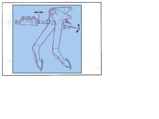

  4. Thank you Loren. I removed the booster spring, cleaned and greased all parts. Actually everything looked ok with the exception of the master cylinder push rod. A shoulder developed in the rod due to friction (see picture) -not sure if that was the cause of the piston not traveling all the way and the unstack metalic noice I heard. :unsure: Doc1.doc As a weekend band-aid I filed the edges off with a dremmel -but if the problem was inside de cylinder most likely I'll have to deal with it again. The master cylinder is $56.75 at Pelican; If anybody has replaced it I would appreciate feedback -I'm mainly concerned with the bleeding process. :help: Rolando My problem started on Thursday after work when I was trying to start the car to come home. I checked a few things and desided lo leave it for somebody with more knowledge so I towed the car to a mecanic. The guy charged me $180 to FIX the problem buy twisting the clutch switch arm so it would engage earlier. The small detail is that I could barely shift gears :soapbox: The independent Porsche guy could not even see the car for a week (too busy) and the dealer would probably replace the clutch pedal, the ignition switch (new metal one), the master cylinder and perhaps the whole clutch :D .... I know ... you get what you pay for. UPDATE: Clutch pedal stayed-in (so much for band-aid fix). Would this validate the clutch master cylinder theory? Help would be much appreciated. :help:
  5. :soapbox: Thank you Loren. I removed the booster spring, cleaned and greased all parts. Actually everything looked ok with the exception of the master cylinder push rod. A shoulder developed in the rod due to friction (see picture) -not sure if that was the cause of the piston not traveling all the way and the unstack metalic noice I heard. :unsure: Doc1.doc As a weekend band-aid I filed the edges off with a dremmel -but if the problem was inside de cylinder most likely I'll have to deal with it again. The master cylinder is $56.75 at Pelican; If anybody has replaced it I would appreciate feedback -I'm mainly concerned with the bleeding process. :help: Rolando My problem started on Thursday after work when I was trying to start the car to come home. I checked a few things and desided lo leave it for somebody with more knowledge so I towed the car to a mecanic. The guy charged me $180 to FIX the problem buy twisting the clutch switch arm so it would engage earlier. The small detail is that I could barely shift gears :soapbox: The independent Porsche guy could not even see the car for a week (too busy) and the dealer would probably replace the clutch pedal, the ignition switch (new metal one), the master cylinder and perhaps the whole clutch :D .... I know ... you get what you pay for.
  6. My clutch pedal was not traveling all the way down, consequently the rocking switch on the back of the pedal did not engage and the car would not start. :cursing: I disconnected the wires from the switch, put them together and the car starts every single time :clapping: After pumping the pedal hard a few times it made a metalic noice, traveled all the way down and seems to work fine (for now). My question: is there anything that I could change/fix inside the barrel/piston that is pushed by the clutch pedal? I do not want this problem to repeat itself <_< Rolando 98 boxster manual
