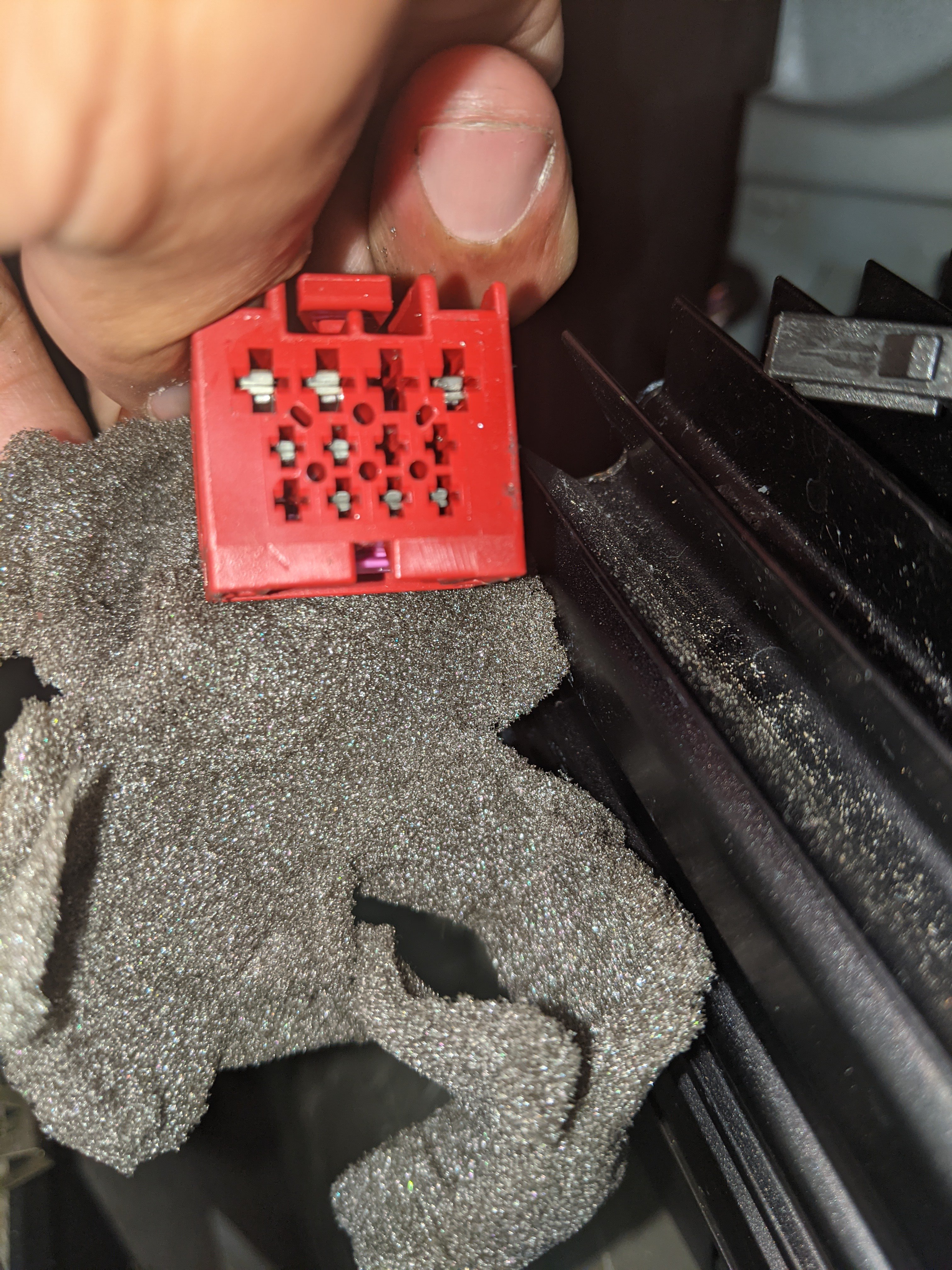

  16. Attached is a picture of the plug I found next to the rear convenience module behind the right trunk panel. To anyone that has the OEM tow system, does this look like the OEM harness plug that goes to the trailer hitch module.
  17. I would like to add that I removed the trunk panels to replace my rear convivence module and I found a red plug wrapped in foam in the area that would be the place for the pre hitch wiring. Even though my build sticker did not have the ID8 code, could this be the plug that goes into the tow hitch module or is it for something else. I read on one installation manual that they describe it as green. I would appreciate any who has done this installation with the pre hitch wiring, what color was the plug that you found.
